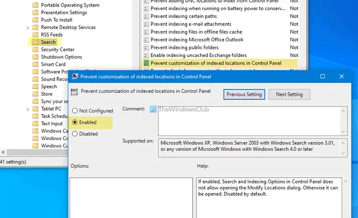

- Navigate to Search in Computer Configuration.
- Double-click on the Prevent customization of indexed locations in Control Panel setting.
- Select the Enabled option.
- Click on the OK button.

Here you can find a setting called Prevent customization of indexed locations in Control Panel on the right side. Double-click on it and select the Enabled option.
Click on the OK button to save the change.

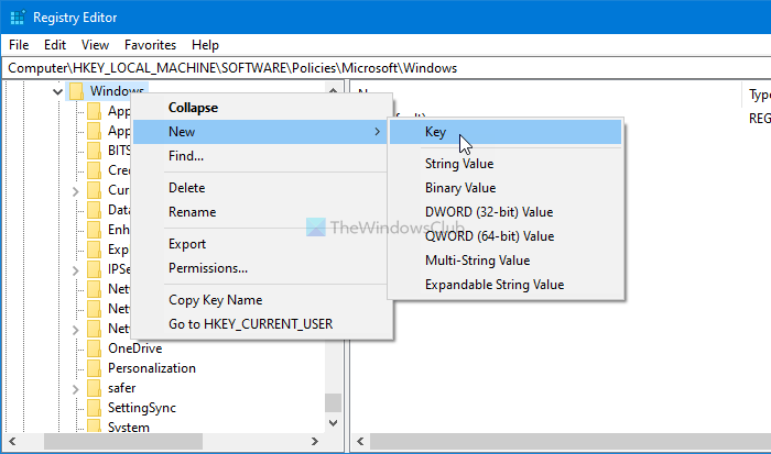

- Right-click on Windows > New > Key.
- Name it Windows Search.

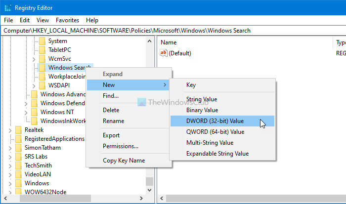

- Right-click on Windows Search > New > DWORD (32-bit) Value.

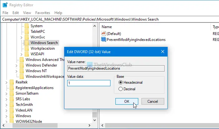

- Name it as PreventModifyingIndexedLocations.
- Double-click on it to set the Value data as 1.
- Click the OK button.

Right-click on Windows > New > Key, and name it Windows Search.
Right-click on Windows Search > New > DWORD (32-bit) Value and name it as PreventModifyingIndexedLocations.
Double-click on this REG_DWORD value to set the Value data as 1.
Click the OK button to save the change.
