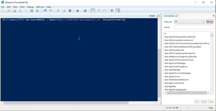

When you try to run a PowerShell script or command with the Export-CSV cmdlet on your Windows 11 or Windows 10 client machine or Windows Server in a domain, you may get Access to the path is denied output. This post offers applicable fixes to the issue.
The error snippet will read something similar to the following output depending on the syntax and parameters specified:
Export-csv : Access to the path ‘C:\export.csv’ is denied.
At line:1 char:14
+ get-process | Export-csv -Path “C:\export.csv” -NoTypeInformation
This error is most likely to occur predominantly due to the following reasons.
- You’re running PowerShell without administrator permissions.
- Incorrect code or syntax of the script that may have extra spaces in the path, like a forward dash or anything else that shouldn’t be there.
- Spelling errors in the PowerShell command.
PowerShell Export-CSV access to the path is denied
If you get the Access to the path is denied error output when you run the PowerShell Export-CSV cmdlet on a Windows client or server machine, then the easy fixes we have presented below in no particular order can be applied to resolve the issue and have the command execute as intended.
- Run the Export-CSV command in PowerShell elevated console
- Change the location of the Export-CSV file/folder
- Name your Export-CSV file
Let’s see these fixes in detail. Make sure that Windows PowerShell script execution is enabled on the machine.
1] Run the Export-CSV command in PowerShell elevated console
As you can see from the lead-in image above, the Export-CSV access to the path is denied error is displayed when the command is run in PowerShell without admin privilege. So, check that this isn’t the case for you. If not, then proceed with the next suggestion; otherwise, open PowerShell or Windows Terminal in elevated mode and then run the command making sure that there are no spelling errors in the command, and in addition, the code or syntax is correct — for example, check for and remove extra spaces in the path, a forward dash or any character that shouldn’t be present in the syntax.
