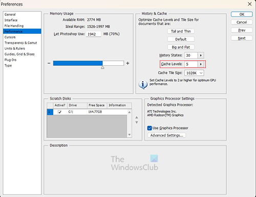

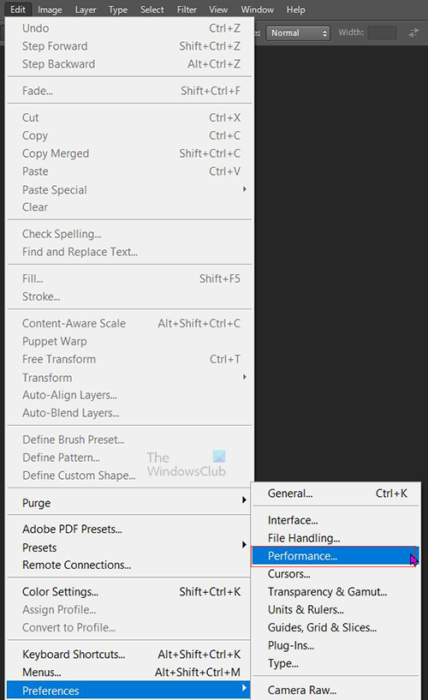

To decrease the History state go to the top menu bar and press Edit then Preferences then Performance.
The preferences window will appear, look for the History state and lower the value. You can choose a History state number that you are comfortable with. You then press Ok to keep the changes and close the Preferences options window.
To increase the cache go to the top menu bar and press Edit then Preferences then Performance.
The preferences window will appear, look for the Cache level, and increase the cache level. The recommendation is a minimum of 2 and the highest it will go is 8. When you have changed the Cache level, press Ok to keep the changes and close the Preferences options window.

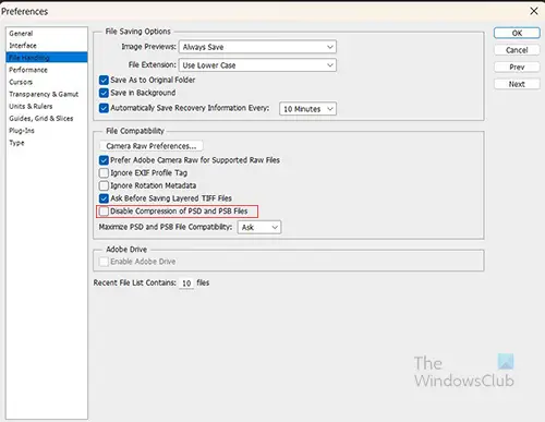

4] File compression turned on
When you are working on your artwork in Photoshop, you will notice that Photoshop will save some files slowly. You may have a fast hard drive and more than enough RAM but it is still taking forever to save. You may think of updating your hardware to make saving faster. However, you may not have to make expensive updates, just tweak Photoshop.
Turn off file compression
File compression is what Photoshop uses to make sure that your Photoshop files don’t fill up your hard drive too fast. As you work and save your work, Photoshop will compress the file while it saves. While this is good, it slows down the save process. You can disable the compression so that the file saves faster. This will make the file much larger on your hard drive. You can choose to compress the file after you have finished making all your changes.

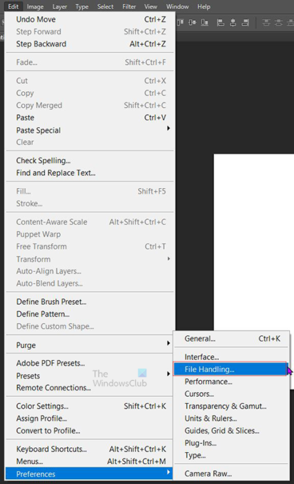

To disable the compression, go to the top menu bar then press Edit then Preferences then File handling.
The preferences options window will open and here you will see the heading File compatibility. Under the heading, File compatibility select the option Disable compression of PSD and PSB files. You will then notice that your files save faster when you are working and when you save your editable PSD files in Photoshop. You will also notice that the files are larger and take up more space on your hard drive.
When you have completed all edits to the file, you can then enable file compression by following the same steps that you used to disable it. You just need to unselect Disable compression of PSD and PSB files. When you have enabled file compression, you then save the file. The file will then be compressed and made smaller.
