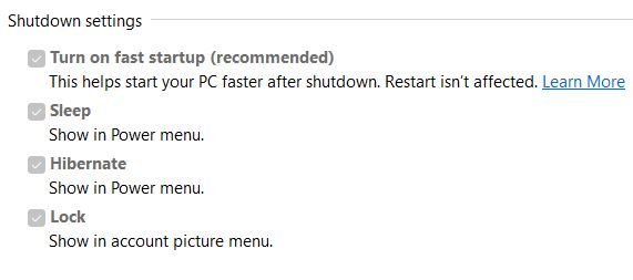

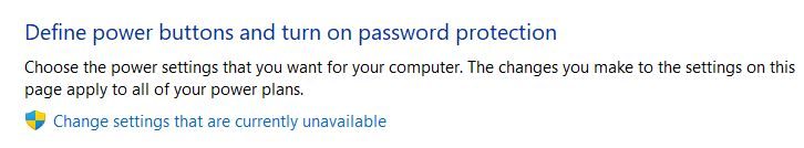

1] Disable Fast Startup
Whenever there is an error with any program, a system restart can sometimes fix it. There may be issues with other programs in the background and the system needs to restart. Shutting down may not help if your computer has Fast Startup enabled. When Fast Startup is enabled, the computer will hold things in memory so that it can start faster after a shutdown. This causes problems not to be fixed after the computer is shut down. The best way to get these issues cleared is to do a restart which will empty the RAM.
If you want to shut down and have the memory emptied, hold Shift then press Shut Down, or disable Fast Startup in power settings.
When you disable Fast Startup, you may notice that it is greyed out, just look above it and you will see Change Settings that Are Currently Unavailable. Click the words and you will see the options get clickable. You can then uncheck Turn on Fast Startup then go to the bottom of the window to Save Changes.

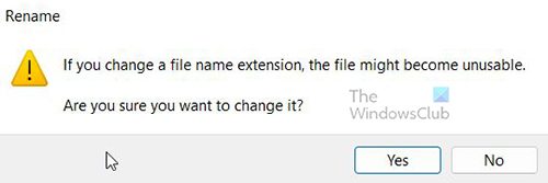

2] Change Image File Extension
Whenever you get the error when you try to open a specific image file, while others work it could mean that the image extension may need changing. You can change the file extension to .jpeg or .png and this may fix the issue. You may try to see if the image will open in another program; if it does open, you can save it and try Photoshop again.
You can change the file extension from the file folder, but you would need to enable the Windows option for showing file extensions.
To enable the showing of file name extension, go to the top of the open folder and click View, then from the drop-down menu go to Show then check File Name Extension. You will notice that the files will now show their extensions such as .jpg or .exe etc. you can edit these extensions.
You will, however have to confirm the change. Changing the file extension can cause problems with files so do so only if you must.

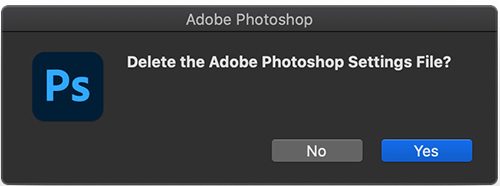

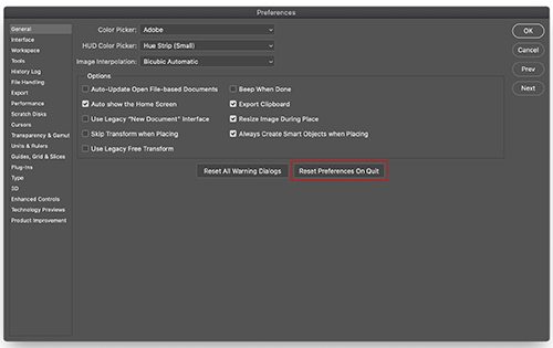

4] Reset Photoshop Preferences
Sometimes when Photoshop displays errors, it can be a result of problems with the preferences. The Preference file may be corrupt or there may be some conflict. Resetting the preferences may fix this issue so it would help to give it a try.
In later versions of photoshop, you can reset the Preferences by using the Reset Preferences On Quit button right on the Preferences window.
You may manually reset preferences by removing the preferences folder. This method ensures all preferences and any user presets which may be causing a problem are not loaded. To try this method close Photoshop and then navigate to the location of the preferences folder.
They are located at:
Users/[user name]/AppData/Roaming/Adobe/Adobe Photoshop [version]/Adobe Photoshop [version] Settings
If you do not see the files, they may be hidden, so you may have to view hidden files.
Remove the entire Adobe Photoshop [Version] Settings folder to somewhere safe for a backup of your settings. Open Photoshop and new preferences files will be created in the original location.
You can also reset the preferences by using the keyboard shortcut when you restart Photoshop. To reset Photoshop’s preferences using the keyboard, quit Photoshop, hold down the Ctrl + Alt + Shift key and launch Photoshop. Click Yes in the dialog that asks, “Delete the Adobe Photoshop Settings file?”
Be sure to back up your preferences before resetting preferences.

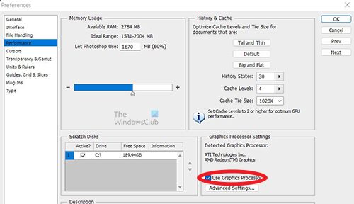

5] Disable Graphics Processor
Disabling the graphics processor may cause Photoshop to render a bit slower since you would be disabling hardware acceleration. However, this may help to fix the Photoshop could not Complete your Request because of a Program Error.
Go to Photoshop’s Preferences > Performance and uncheck Use Graphics Processor and restart Photoshop.

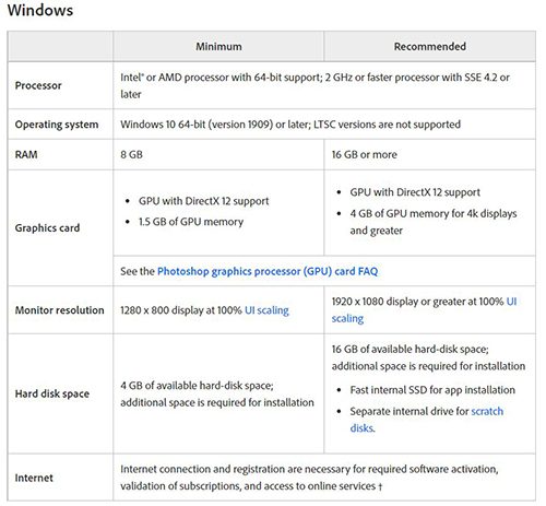

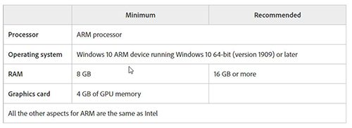

6] Minimum System Requirements not met
This error can show up if your system does not meet the minimum requirements for running Photoshop. Check on adobe.com to see the system requirements of Photoshop and compare them to the specification of your system. There you will find system requirements for Photoshop. Compare these system requirements with your computer’s specifications. You can search for System Information on your computer to see a summary of the system.
These are the system requirements for Photoshop

How can Unmet System Requirement cause the Photoshop could not complete your request because of a Program Error?
Photoshop could not Complete your Request because of a Program Error can be caused by the high demand of Photoshop on a system that does not meet the minimum requirements. Photoshop requires a good graphics card, if this is not met then the system will slow down, crash or display the error. The same can happen if the rest of the requirements are not met.
