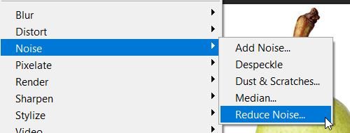

From the top menu go to Filter then Noise and Reduce Noise.
If the image is blocky or pixelated from saving it as a low-quality JPEG, select Remove JPEG Artifacts. Adjust the Strength, Preserve Details, Reduce Color Noise and Sharpen Details.
Click on Advanced to apply the Reduce Noise Filter to specific color channels. Make sure that Preview is selected so that you can observe the changes on the image as you make them. You will have to observe the changes in the image so that you can know which changes work. Remember there is no ready-made formula to fix the blur so you will have to experiment until it is satisfactorily fixed. When you are satisfied with the result press OK.

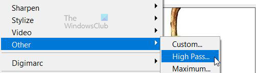

Go to Filter and then Other, then select High Pass. Adjust the Radius using the slider or click in the value area and use the Up or Down arrow keys to adjust the value. A higher radius value causes more sharpening. Note the effects of the filter on your image in the document window. When you are satisfied with the outcome, click OK to apply the filter.
You can lower the Opacity if you wish to fade the sharpening effect.
