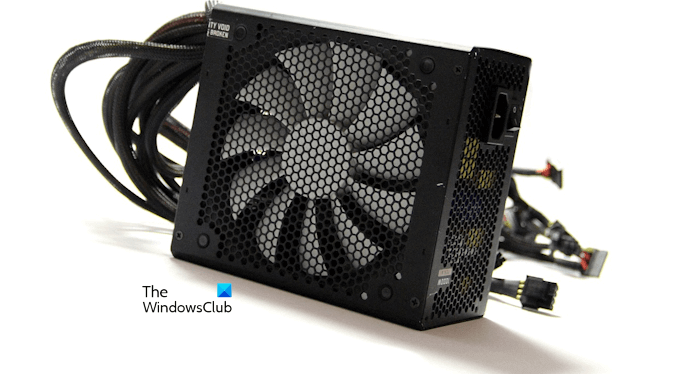

If your PC shuts down when installing Windows 11, this article will help you. This issue usually occurs due to hardware issues, such as overheating, power supply issues, motherboard issues, etc., but it can also be due to BIOS issues.

Both hardware and software issues are responsible for an unexpected shutdown of a Windows computer. Sometimes, it can be due to power issues or a faulty power supply unit. A faulty RAM or motherboard can also cause an unexpected shutdown. You should also monitor your computer’s temperature.
