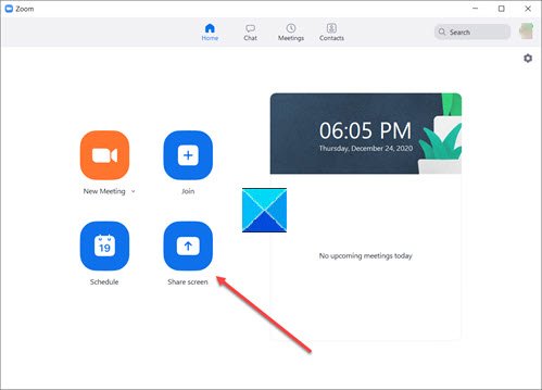

- Click the Share screen button at the bottom of the meeting window.

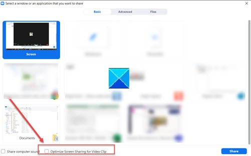

- Choose the screen you want to share.
- Select Optimize Screen Sharing for Video Clip.

At the bottom of the meeting window, click the Share Screen button located under the meeting controls.
Now, select the screen you want to share. Once you choose a screen, the Optimize Screen Sharing for Video Clip option will become visible at the bottom of the screen.
Check the box marked against the above option.
Then, click the Share button to start playing your video in full-screen while sharing your screen.
