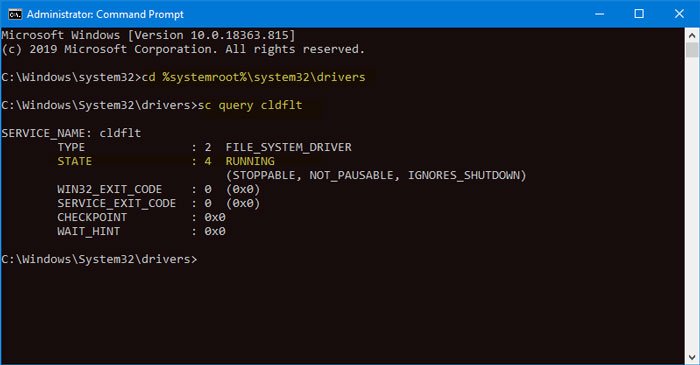

3] Verify if Windows Cloud Filter Driver is running or not
To verify whether the Windows Cloud Filter Driver is running on your computer or not, you can take the help of Command Prompt. A couple of commands can help you out, no matter whether you need to verify or enable it. To get started, run Command Prompt with administrator privilege, and type this command-
cd %systemroot%\system32\drivers
Hit the Enter button. After that, type the following command-
sc query cldflt
After pressing the Enter button, your Command Prompt should display a result like this-
The STATE should show as 4 RUNNING. If it is showing anything else, it is the time to enable it on your computer. For that, type the following command in the Command Prompt window-
sc config cldflt start=auto
Press the Enter button. If nothing wrong happens, you should see a success message saying [SC] ChangeServiceConfig SUCCESS.
Now, you should restart your computer and check if you can access the file or not. If not, the other guide might be helpful for you.

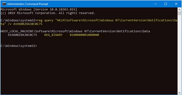

4] Verify if Windows Cloud Filter Driver is attached to the drive
If the cldflt.sys is not linked to the driver where the sync folder is located on your Windows computer, you can find this error message. It happens after an update or malware attack. Therefore, you need to verify this setting. The best thing is that you can do this job with the help of Command Prompt.
At first, you need to follow this guide to open an elevated Command Prompt window on your Windows computer. After opening it, paste the following command-
reg query "HKLM\Software\Microsoft\Windows NT\CurrentVersion\Notifications\Data" /v 41960B29A3BC0C75
and hit the Enter button. You should see a result like this-
REG_BINARY 0100000001000000
If it is showing anything else, you need to execute this command-
Fltmc attach cldflt c:
You should keep in mind that the “c” in the above command is the drive where the OneDrive folder is placed on your PC.
Now restart your computer and use the Files On-Demand as usual.
