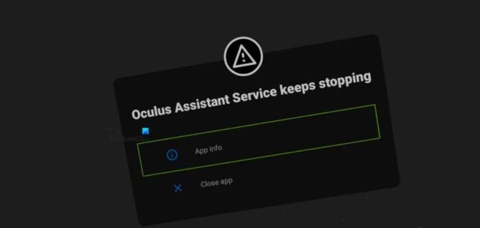

A lot of users reported that they are unable to use the keypad of their Oculus device. When trying to do the same, they encounter Oculus Assistant Service keeps stopping pop-up. In this post, we are going to talk about them and see what you can do to resolve the issue and use the keypad without any hiccups.
Fix Oculus Assistant Service keeps stopping
If Oculus Assistant Service keeps stopping, execute the following solutions to resolve the issue.

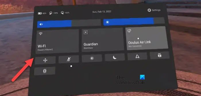

2] Restart Oculus’s WiFi
You may also encounter this issue because of some network glitch. The best way to resolve the issue, in that case, is by turning off and on the WiFi of your Oculus device. To do the same, launch Quick Settings and click on the WiFi icon. Then, use the toggle to disable the WiFi of your device. Finally, turn it back on and see if the issue is resolved.
If this doesn’t work, try power cycling your router. This flushes out any glitches in your network as well as the network devices. Follow the prescribed steps to do the same.
- Turn off your router.
- Unplug all its cables.
- Wait for 30 seconds, turn on your device as well as plug in your cables.
Finally, check if the issue persists.

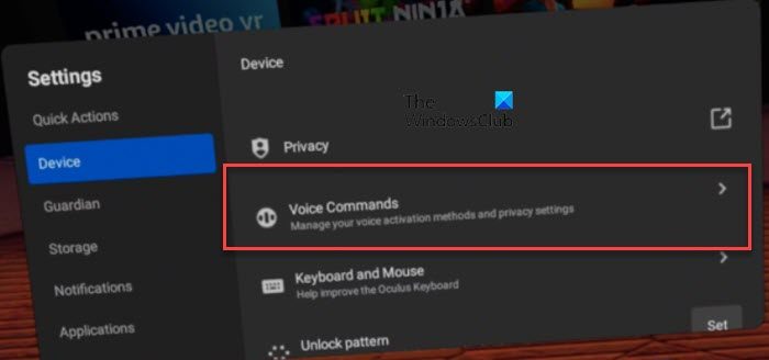

3] Disable Voice Commands
If you are not able to find any Voice Commands updates, then maybe the bug-fixer is not released for your device. In that case, we need to turn off Voice Commands and wait for an update to be released. Once the update is released, you can install it and turn the feature back on. Untill then, keep it disabled, and follow the prescribed steps to do the same.
- Launch Settings and head to System.
- Click on the Voice Commands option.
- Turn off every single feature.
Finally, restart your device and check if the issue is resolved. In case, the issue is fixed after disabling this feature, wait for an update and download it when available.
