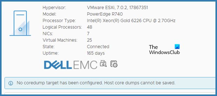

When running the Esxcli command, VMWare users may get a warning that says that the core dump target has not been configured, so the host core dumps can not be saved. This issue has been noted after updating the host version. In this post, we will discuss this issue and see what can be done to resolve it.
No coredump target has been configured. Host core dumps cannot be saved
Fix No coredump target has been configured, Host core dumps cannot be saved
If you get No coredump target has been configured, Host core dumps cannot be saved message in VMWare when running the Esxcli command or making some changes to the disk, follow the solutions mentioned below to resolve the issue.

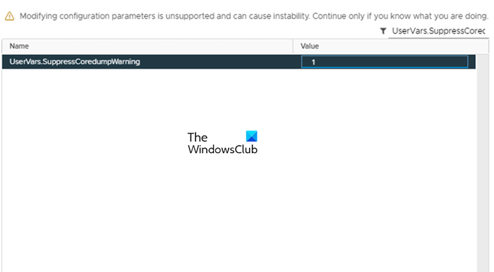

3] Disable the warning
If you don’t like the message that’s displayed, and you want to disable it, just go to ESXi Host > Configuration > Advanced Settings, look for UserVars.SuppressCoredumpWarning, and set its value to 1.
