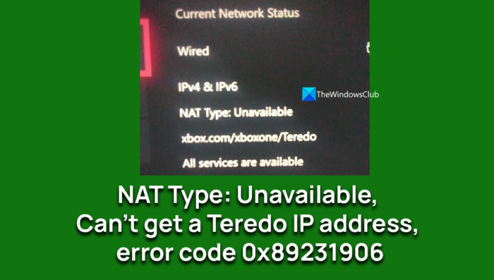

Xbox has multiplayer gaming capabilities and party chats. You can host or join a multiplayer gaming session or join a party chat. To do that, you need to have an Open NAT type to avoid any issues that occur while joining them. An Open NAT is available through Public IP address assigned by your ISP. You can enable it by turning on UPnP in the router’s settings if you have a Public IP address. Some users are seeing errors like NAT Type: Unavailable, Can’t get a Teredo IP address, and error code 0x89231906 on their Xbox consoles while trying to join a party chat session, or testing the multiplayer connection. In this guide, we have a few fixes that can help you fix them.
NAT Type: Unavailable, Can’t get a Teredo IP address, error code 0x89231906
If you are seeing the following errors on your Xbox console,
- NAT Type: Unavailable in the Network settings of your console
- Can’t get a Teredo IP address when you select Test multiplayer connection in Network Settings
- Error code 0x89231806 while you are joining a party chat session
You can follow the methods mentioned below to fix these issues.
- Enable Teredo connectivity and IPv6
- Turn on UPnP
- Open network ports
- Reset your router to factory defaults
Let’s get into the details of each method and fix the issues.
