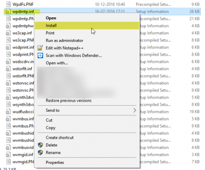

3] Install the “wpdmtp.inf” file
A manual installation of the “wpdmtp.inf” file has helped a lot of people fix the issue. This method may also solve your problem.
Follow the steps below:
- Open Windows Explorer and open your C drive.
- Now, open the Windows folder and then open the INF folder.
- Look for the file named, wpdmtp.inf.
- Once you find the file, right-click on it and click Install. Follow the on-screen instructions.
After the installation process is completed, connect your portable device to your computer and check whether the issue is fixed.
