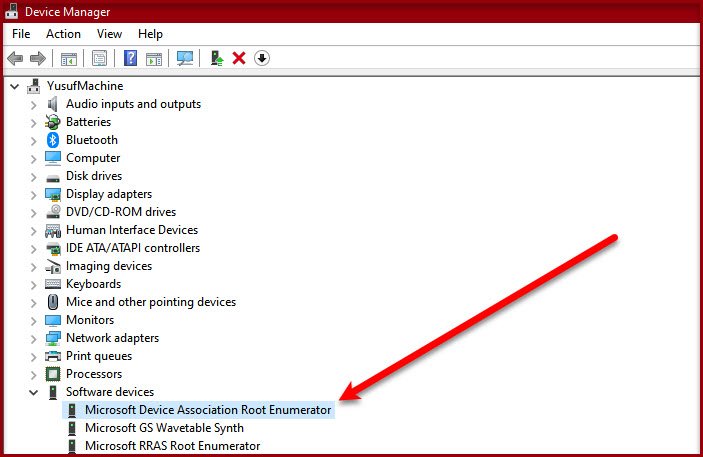

- So, launch Device Manager by Win + X > Device Manager or from the Start Menu.
- Expand Software devices to see Microsoft Device Association Root Enumerator.

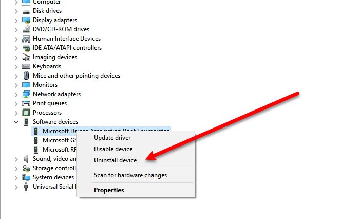

- Now, right-click on the driver to Update, Uninstall or Disable.

2] Reinstall Microsoft Device Association Root Enumerator
If the troubleshooter is unable to fix the issue, we need to reinstall the driver. So, uninstall Microsoft Device Association Root Enumerator from the Device Manager.
After uninstalling the driver, restart your computer and Windows will automatically reinstall it.
