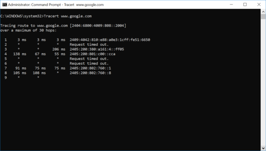

2] TRACERT
Tracert is a command-line utility used to trace the route of the data packets sent over the network. Just like ping, Tracert is used to test network connectivity issues. The command traces the route of the data packets to the destination and tells you how many nodes they encountered along the way. If you are experiencing network connectivity issues, this command indicates which hop the problem occurs on.
Type the following (or type internet server you want to test)-
tracert www.google .com
The output shows the detailed list of each hop along with the IP address of the node and latency between your Windows and that particular hop.

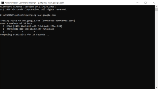

3] PATHPING
Pathping is a command-line utility used to troubleshoot network connectivity issues. This command is similar to Tracert in function but more detailed information of the data packet route.
The command sends data packets to a destination address and analyzes the route in detail. It computes packet loss on a per-hop basis and helps find out the problematic hop.
Execute the following (or type domain server you want to test):
pathping www.google.com

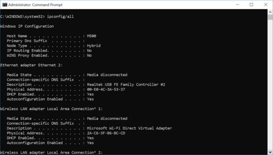

4] IPCONFIG
Ipconfig is a popular command-line utility used to test network connectivity issues on a TCP/IP network. It gives detailed information about the IPv4 address, WLAN Adapter, and Ethernet Adapter. It is often used with switches to execute certain tasks.
Execute the following to view connection configurations-
ipconfig/all
Execute the following to know more about the advanced switches-
ipconfig /?

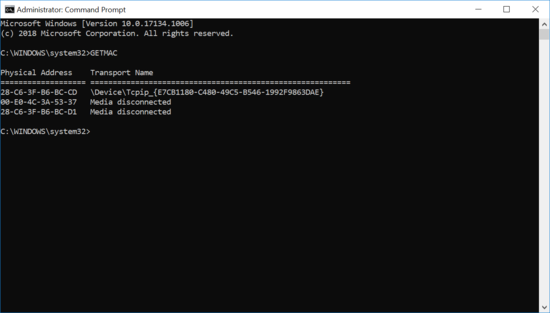

5] GETMAC
Getmac is a command-line utility used to retrieve the mac address of your computer as well as remote computers. In Windows, MAC address is nothing but a physical address used to identify devices connected to your computer network. You can use a MAC address to limit the hardware devices connected to the network.
Type the command to get the MAC addresses of each hardware connected to the network:
getmac

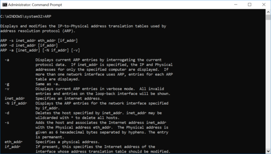

10] ARP
ARP is a command-line utility used to display a resolved MAC address. It displays and modifies the IP address to physical address translation tables used by the address resolution protocol. Every time your computer uses ARP to find the MAC address associated with an IP address, it stores the mapping in the ARP cache for future lookups.
This command is useful for checking whether there are any duplicate IP assignments. To display the cache entry type:
arp -a
