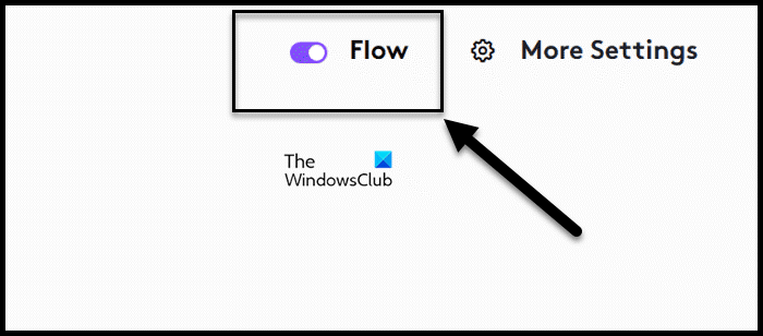

2] Turn on Flow options
You need to make sure that the Flow option is enabled on both systems you are trying to connect to. Also, make sure to reboot your computer after enabling the feature so it works without any issues. Follow the steps mentioned below to enable Logitech Flow.
- First of all, launch the Logitech Options+ on your computer.
- Go to the device you want the flow to work on, it should be connected to your computer first.
- Then go to the Flow tab and enable the Flow toggle.
Finally, restart your computer and check if the issue is resolved.

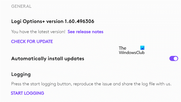

4] Check Logi Options+ Update
You need to make sure that Logi Options+ is always up-to-date. If the app is outdated, you will not be able to use Logi Flow as there will be a disparity between the versions of Logi Options+ installed on both computers. To check for updates, follow the steps mentioned below.
- Open Logi Options+ on your computer.
- Click on the cog icon to open its Settings.
- Then, click on Check for updates from the General section. Also, make sure to enable the toggle for Automatically install updates.

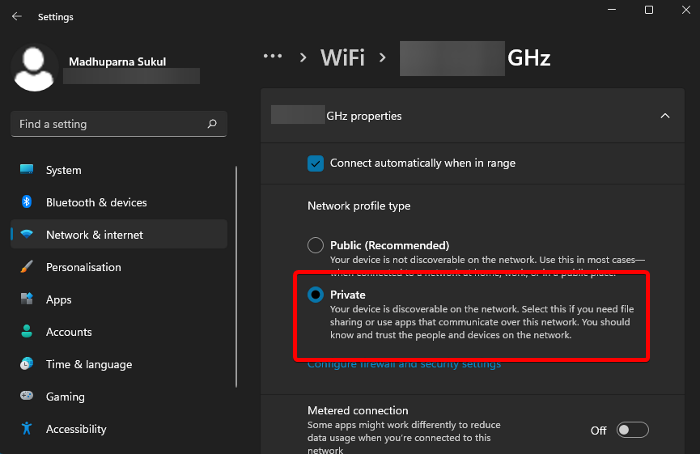

5] Switch to Private WiFi Network
If you are facing issues with Logitech Flow on Windows, it might be due to your Wi-Fi network settings. Your network may have accidentally changed from private to public. To resolve the issue, you can follow these steps to make your Wi-Fi network private on a Windows PC.
- Open Settings using the keyboard shortcut Win + I.
- Then go to Network & internet > WiFi.
- Click on the WiFi network you are connected to.
- Then click on Private network.
- Finally, close Settings.
Reboot your computer and check if the issue is resolved.

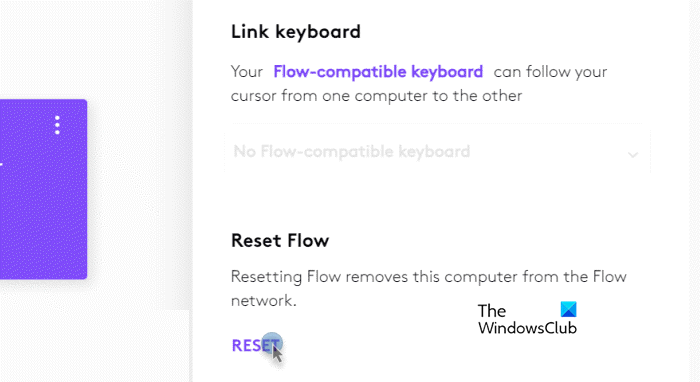

6] Reset Flow configuration
If you made some alterations to the configuration of Flow, there is likely something wrong with it, which prevents you from connecting to multiple devices. In that case, we need to reset the Flow configuration. Follow the steps mentioned below to do the same.
- Launch Logi Options+.
- Then click on the cog icon to enter its Settings.
- Now, go to Flow > More Settings.
- Click on RESET associated with Reset Flow.
