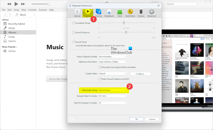

4] Change your iTunes playback preferences
Some users have confirmed that changing their iTunes playback preferences has helped them fix this issue. So, you can try doing the same and see if it works for you. Here’s what to do:
- First, open iTunes and click on the Edit > Preferences option.
- Now, move to the Playback tab.
- After that, set the Play Audio Using option to Direct Audio.
- Next, press the OK button to save changes.
- Finally, restart iTunes, plug in your headset, and see if the issue is fixed.
