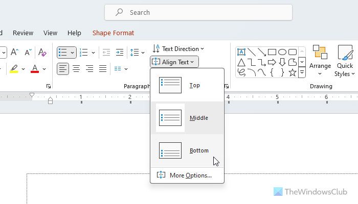

3] Align bulleted text vertically in a Text Box

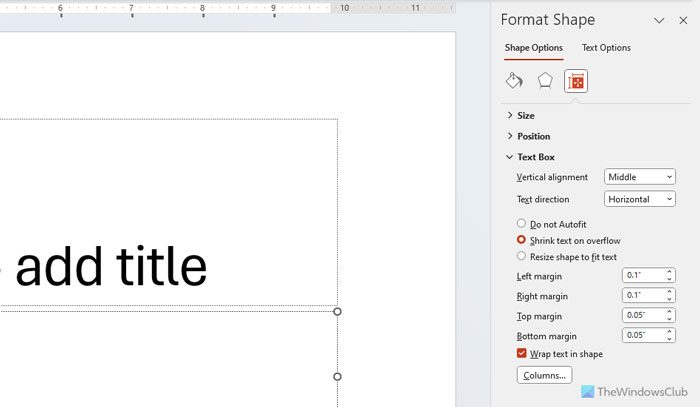

For those who prefer to have things set vertically, we are going to explain how to align things vertically when in a Text Box. Getting it done is super easy. Just return to the Paragraph section under the Home tab, and click on the following icon.
As you can see, three options appear so click on either one to make changes to your document. If you want to go deeper into the more advanced stuff, select More Options.
From this section, the user will have more options for vertical alignment, text direction, and much more.
