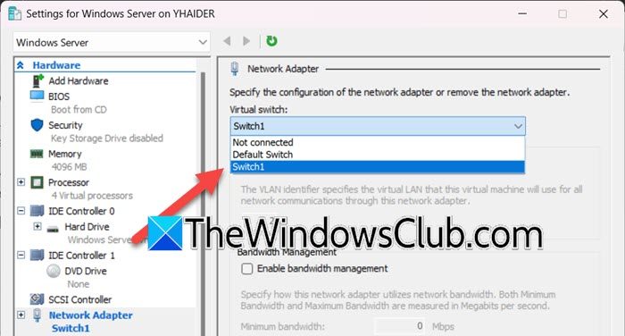

2] Create another switch and add it to your VM
There is a possibility that your virtual switch is corrupted or has some glitches due to which you are experiencing network dropouts. In order to resolve the issue, we will have to create a new switch and add it to our virtual machine. To do so, follow the steps mentioned below.
- Open the Hyper-V Manager.
- From the Actions section, click on the Virtual Switch Manager.
- Select New virtual network switch, then choose “External” (you can select Internal or Private as well if you know what you are doing), and then click on Create virtual switch.
- Give the switch a name and click on Apply > Ok.
Once you have created the new switch, we will remove the current switch that your VM is using and add the new one.
- Right-click on the virtual machine and select Settings.
- Go to the Network Adapter tab, and then from the drop-down menu associated with Virtual Switch, select the switch we created.
- Finally, click on Apply > Ok.
After setting up the system, reboot the computer, and launch your VM, hopefully, it will start working.

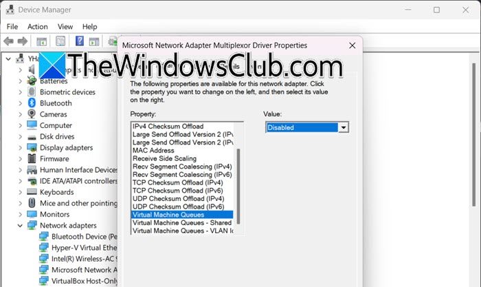

3] Disable Virtual Machine Queue of the host network adapter
Virtual Machine Queue (VMQ) helps improve network performance in virtualized environments. However, at times, VMQ has been caught causing issues with the virtual machine’s network. Since it is not a must-have feature, we can go ahead and disable it. To do so, follow the steps mentioned below on your host and virtual machine.
- Open the Device Manager by Win + X > Device Manager.
- Now, look for Network adapters and expand it.
- Right-click on the network adapter (since there are multiple adapters, you need to look for the one that has VMQ) and select Properties.
- Go to the Advanced tab, select Virtual Machine Queue from Property, and then select Disabled from Value.
- Click on Ok.
Finally, reboot your host machine and then see if the issue is resolved.

How do I disable Vmq on my Broadcom network adapter?
To disable VMQ, you can open the Device Manager, expand the Network adapters, right-click on the Broadcom network adapter, go to Properties > Advanced, look for Virtual Machine Queue, and set it to Disabled. Alternatively, run the Disable-NetAdapterVmq command in either Command Prompt or PowerShell (as an admin).
