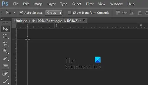

The ruler is usually located at the top and left side of the work area. If the ruler is not visible, you can go to the top menu bar and press View then Ruler or press Ctrl + R. both options will toggle the Ruler on and off. Whenever you move the cursor in the work area you will see marks moving on the rulers showing the position of the cursor on the screen. The ruler is accurate and can be used to get the measurement of objects and the distance between objects in the work area. If you click and drag from the ruler to the canvas, you will get guides. The guides along with the ruler can help to align objects on the screen accurately.

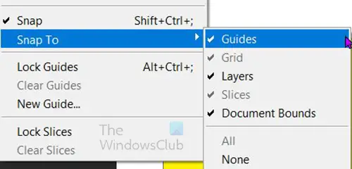

- Choose View > Snap To, then choose any combination of options from the submenu.
This snaps the ruler origin to guides, slices, or document bounds. You can also snap to the grid.
- This method of setting the zero origin will require you to put the cursor at the top left of the screen where the rulers meet, you will click and drag the cursor diagonally toward the canvas.
You will see the crosshair and some lines appear as you drag, wherever you stop will be the new zero origin.

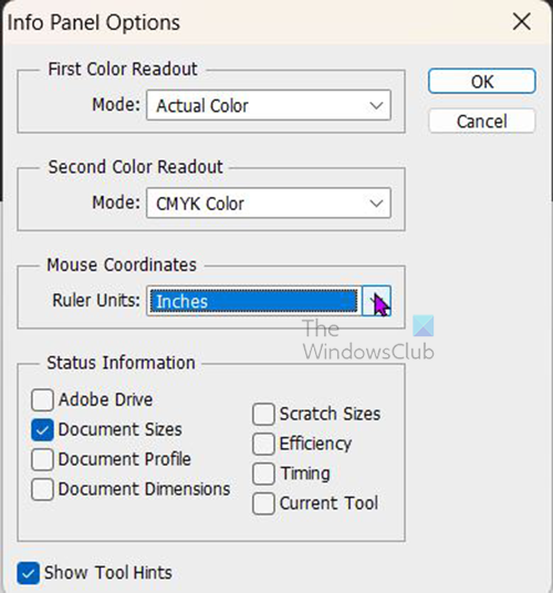

- Double-click any of the rulers, and the Preferences window with the Units options will appear. Choose the unit of measurement that you want then click Ok to confirm or Cancel to exit without committing changes.
- You can also go to Edit then Preferences then Units and rulers. The Preferences window with the Units options will appear. Choose the unit of measurement that you want then click Ok to confirm or Cancel to exit without committing changes.

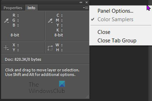

- You can also change the unit of measurement from the Info panel. Go to the info panel in the work area. If it is not there go to Window then Info or press F8.
On the top left corner of the info, panel click the menu button and choose Panel options from the menu that appears.
