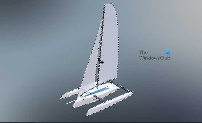

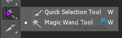

For this image, the Magic wand tool will be used. The Magic wand tool will do well because it will select the image easily.
To access the Magic want tool, go to the left tools panel and click the Magic wand icon, To select multiple places without breaking the selection, hold Shift while you select.
Instead of selecting the background, the subject in the image will be selected.

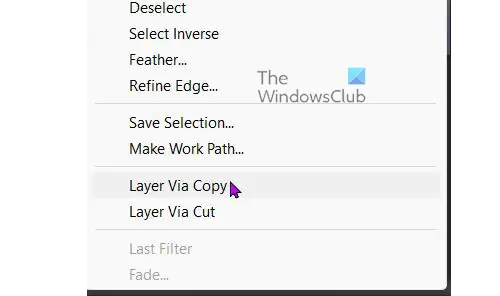

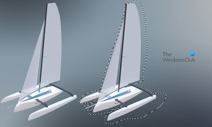

When the full subject has been selected, right-click on the subject image and choose Layer via copy. This will create a new layer using the selected areas. Ensure that the selection is well done or the copy will have missing pieces, the missing pieces will not be obvious until the original image is gone. To see if the copy has all the parts turn off the original by clicking the eye icon on its layer. The copy layer will be left and you will be able to see if there are any missing pieces. If there are missing pieces, turn on the original layer and go to the History panel and go back to the last Magic wand action. Make sure that the Magic wand tool is selected and hold Shift and click the unselected areas that are missing, you may have to zoom in to see properly.
When you have verified that all the subject image has been selected and copied as a new layer, you can select the new layer and move it. You should see two of the subject image.

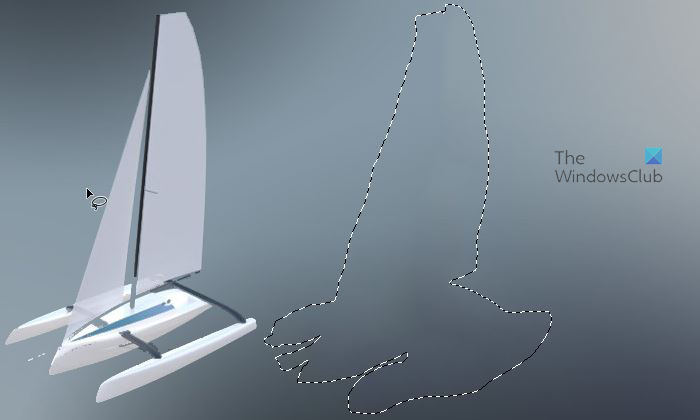

To use the Content-aware feature you will have to select the part that you want to cover. Go to the left Tool panel and click the Lasso tool. Hold the left mouse button and then drag around the image that you want to remove, make the line as close as possible without cutting the image. The outline does not have to be neat. Notice the image with the outline, that is the original subject image, it will be filled over.

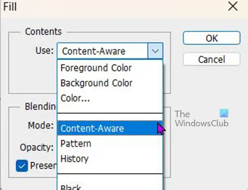

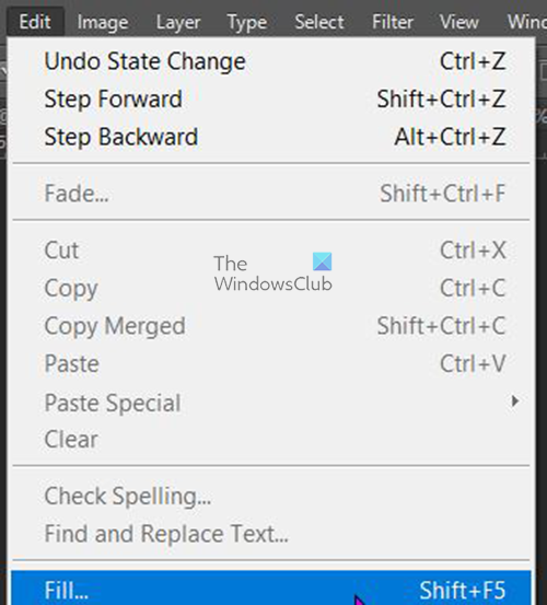

When the outline is finished, go to the top menu bar and select Edit then Fill or click Shift + F5 or Shift + Backspace.
The Fill option box will appear. under Content click the drop-down arrow and choose Content-aware. When you have chosen Content-aware click OK to confirm or Cancel to stop the procedure.

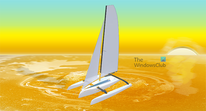

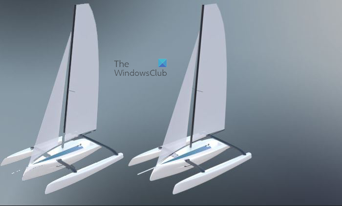

When you have clicked Ok you will notice that the object that was selected is gone and the background is there with the copy of the object. The Content-aware filled the spot with the background color. To get rid of the outline just click inside it with the selection tool.
You will notice that the background and the subject image are separate, you can move the subject image without affecting the background, you can also make changes to the subject image and the background will not be affected. You can also make changes to the background and the subject image will remain the same.
5] Beautify the final image
You can choose to add things to the background, In this article, I will add some juice and have the boat sail in it. You can choose to blur the background or change the color or do anything else that you want.
