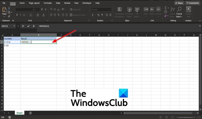

Launch Microsoft Excel.
Create a table or use an existing table.
Type the function =IMSIN(A2) into the cell you want to place the result.
Cell A2 has the complex number you want to sine.

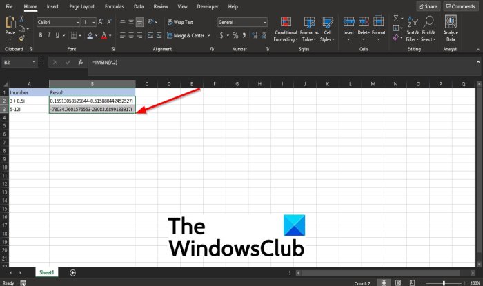

Then press the Enter key to see the result.
Drag the fill handle down to see the other results.

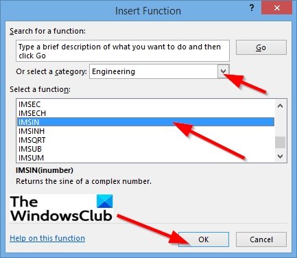

Method one is to click the fx button on the top left of the excel worksheet.
An Insert Function dialog box will appear.
Inside the dialog box in the section, Select a Category, select Engineering from the list box.
In the section Select a Function, choose the IMSIN function from the list.
Then click OK.

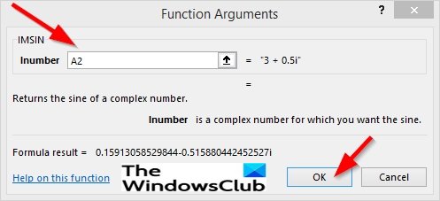

A Function Arguments dialog box will open.
In the Inumber section, input into the entry box the cell A2.
Then click OK.

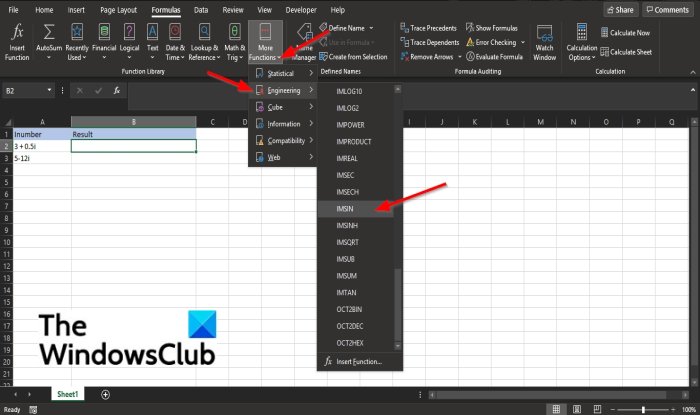

Method two is to click the Formulas tab and click the More Functions button in the Function Library group.
Hover the cursor over Engineering and select the IMSIN function from the list.
A Function Arguments dialog box will appear.
