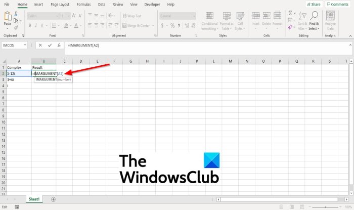

Type the formula into the cell you want to palace the result =IMARGUMENT(A2).

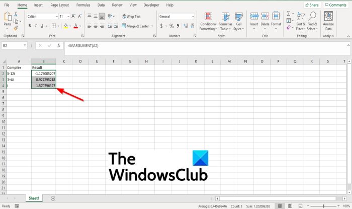

Then press the Enter key to see the result.
If you have more than one data in the table, you can click the result and drag the fill handle down to see more results.

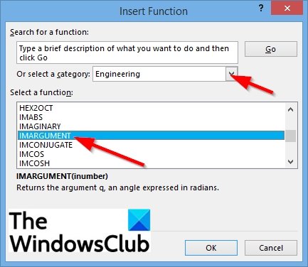

Method one is to click the fx button on the top left of the Excel worksheet.
An Insert Function dialog box will appear.
Inside the dialog box in the section, Select a Category, select Engineering from the list box.
In the section Select a Function, choose the IMARGUMENT function from the list.
Then click OK.

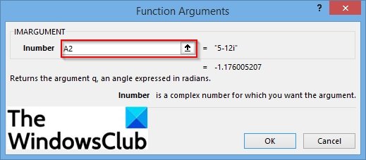

A Function Arguments dialog box will open.
In the Inumber entry box, input into the entry box cell A2.
Then click OK.

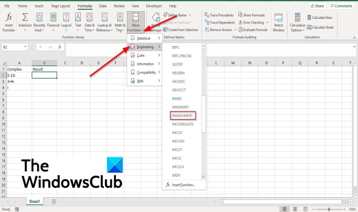

Method two is to click the Formulas tab, click the More Functions button in the Function Library group.
Then click Engineering and select IMARGUMENT from the drop-down menu.
