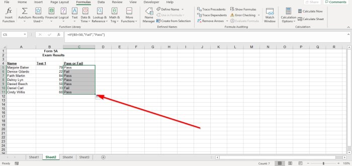

In the cell, type =IF(B5>50,” Fail”, “Pass”) in which B5>50 is a logical_ test, “Fail” is value_if_true and “Pass” is value_If_false. Press
Press Enter, and you will see your result.
You do not have to retype the value into other cells to get a result. You can click on the cell with the result, where you see a small box at the end of the cell, take your cursor and drag it down. You will see the result of the other cells.

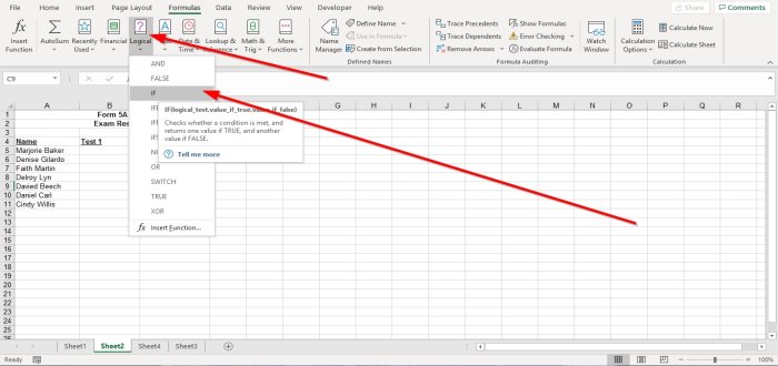

The other option is to click on the Formulas tab.

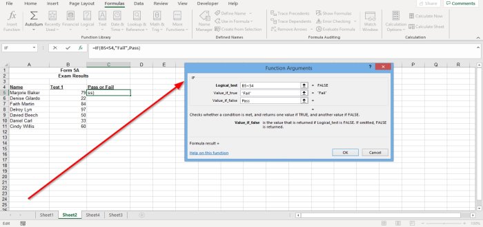

In the Function Library group, click the Logical tool. The Logical tool adds a Logical Function to your library. In the drop-down menu, select the IF function. A Function Argument dialog box will appear.
In the function Argument Dialog Box, type B5<54 in the logical_test entry box, then type “Fail” in the value_if_true entry box and Type “Pass” in the value_If_false entry box. Then press OK.
You will see the result.
