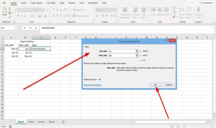

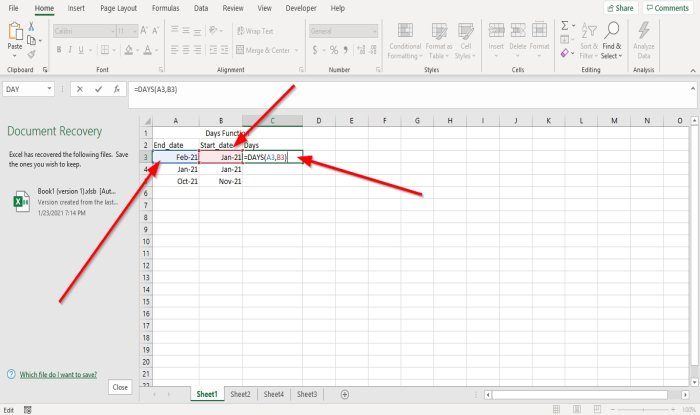

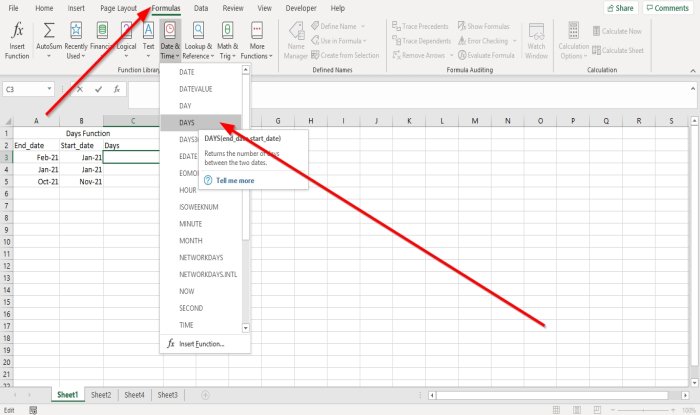

Click the cell where you want to see the result, then type =DAYS (A3, B3).

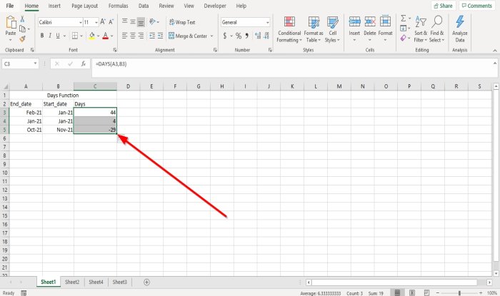

Place the cursor at the end of the cell. You will see a plus symbol; drag it down. You will see the other results in the other cell.

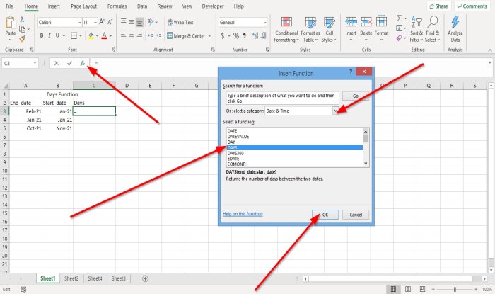

Option number one is to click on fx; an Insert Function dialog box will appear.
In the Insert Function dialog box, you can select the category of function you want. Select the category Date and Time.
In the Select a function list, select DAYS.
A Function Arguments dialog box will appear. In the dialog box, where you see end_date type A3 or click the cell A3, it will appear in the entry box.
At Start_date, type B3 or click the cell B3, which automatically appears in the entry box.
Now, click OK you will see your result.
Click on the bottom edge and drag to see other results.

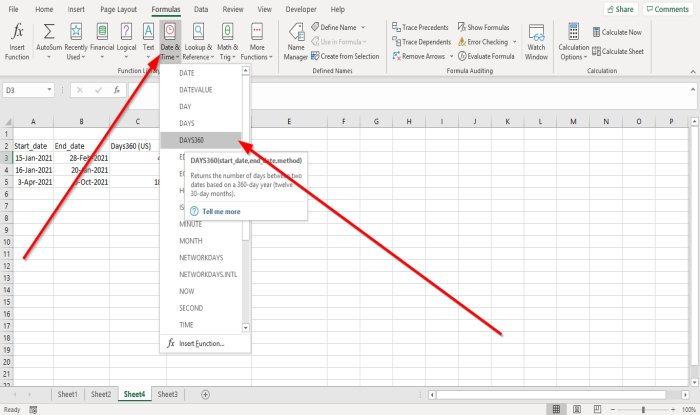

Option Two is to go to the Formulas tab. In the Function and Library group, click Date and Time; select DAYS in its drop-down list. Functions Arguments dialog box will appear.
In the Functions Arguments dialog box, at the End_date, type A3 or click the cell A3, which automatically appears in the entry box.
At Start_date type, B3 or click the cell B3, it will automatically appear in the entry box.
Select Ok; you will see your results.

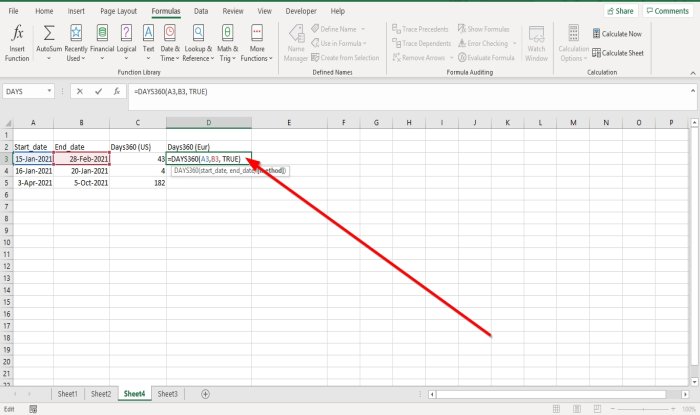

Click the cell where you want to place the result. Type = DAYS360 then bracket.

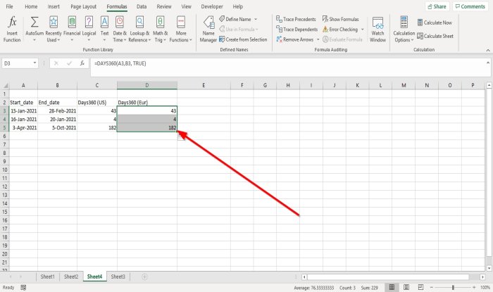

Inside the bracket, type A3, B3, FALSE for US or A3, B3, TRUE for Eur, then close the bracket. FALSE and TRUE are optional.
Press Enter, you will see your result.
Click on the bottom edge and drag to see the other results.

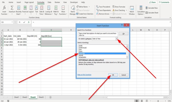

In the Select, a function list, click DAYS360.
A Functions Arguments dialog box will appear. In the dialog box, where you see Start_date type A3 or click the cell A3, it will appear in the entry box.
At End_date, type B3 or click the cell B3, which will automatically appear in the entry box.
Now, click Ok you will see your result.

Option Two is to go to the Formulas. In the Function and Library group, click Date and Time; in its drop-down list, select DAYS360. Functions Arguments dialog box will appear.
In the Functions Arguments dialog box, where you see Start_date type A3 or click the cell A3, it will appear in the entry box.
At Method, type TRUE or FALSE into the entry box.
