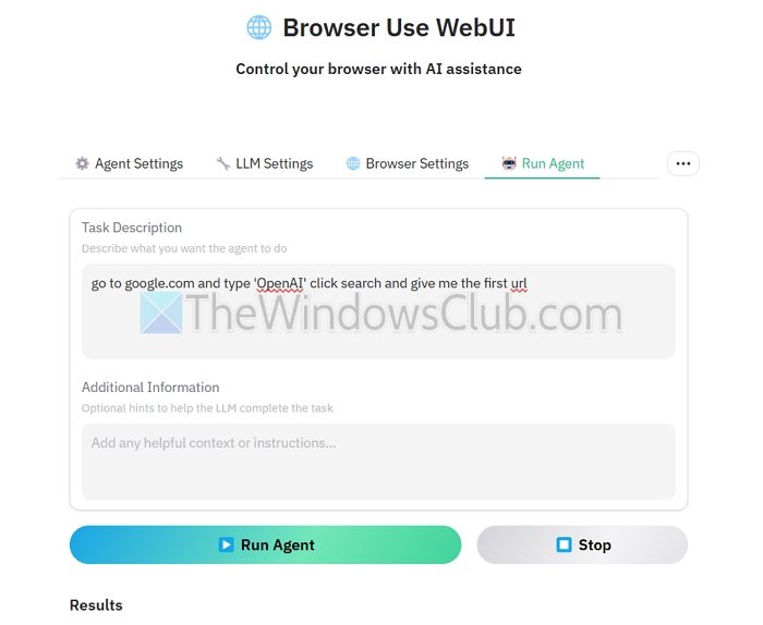

5] Running Browser Use
Once you have installed everything, it’s time to start your project. So, in the command prompt, run the following command:
python webui.py --ip 127.0.0.1 --port 7788
After running the command, wait for a moment, and you will see a URL with an IP address on the screen. Simply copy and paste it into your browser’s address bar, or you can use this URL: http://127.0.0.1:7788/.

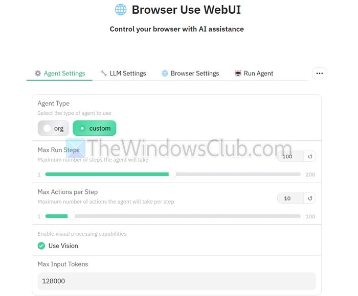

6] Configuring & Running Browser Use
From the Browser Use dashboard, you will need to configure your AI agent tool.
- First, click on LLM settings. From here, select your LLM provider, model name, base URL, and API key.
- Next, go to Agent settings and configure your agent type, maximum run steps, actions per step, and other settings. The same needs to be done for Browser Settings (configure these settings as per your requirements).
- Finally, go to Run Agent, type a task description and additional information, and click on the Run Agent button to start using it.
