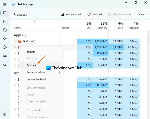

4] End the non-responding program(s)
Now, if Windows is working, then there would be some unresponsive program(s) because of which you face this trouble. So, you need to find and end those non-responding programs.
If the computer is not deadlocked and the keyboard can be used, press the Ctrl+Alt+Delete hotkey. Highlight the Task Manager (using the down arrow or Tab key if you can) in the resulting screen, and hit the Enter key. You can also try to open the Task Manager directly using the Ctrl+Shift+Esc hotkey.
Use the Up and Down arrow keys to select an unresponsive program (or process), and press the Document key or Menu key on the keyboard to open the right-click menu. If the Menu key is not present, press Shift+F10 for the selected process. Highlight the End task option in the right-click menu, and then press the Enter key to end the process. Alternatively, you can also use the Alt+E hotkey for the selected process to end it.
