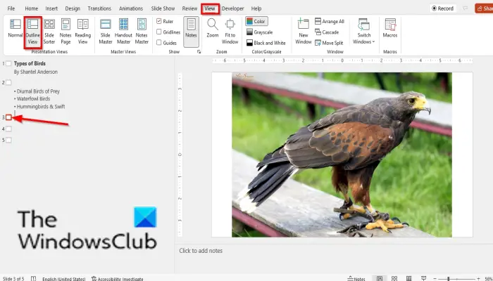

How to switch to Outline view in PowerPoint
Launch Excel.
Create a presentation or use an existing one.
Click the View tab and select Outline in the Presentation views group.
The Outline view allows users to edit and jump between slides in your Outline pane.
On the Outline View pane, click the small bullet boxes, which represent the slides. You can also edit your slides in this view.

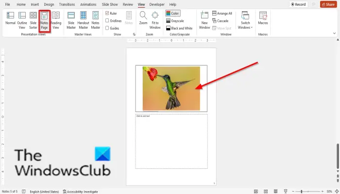

How to switch to Note Page view in PowerPoint
Click the View tab and select Notes Page in the Presentation views group.
The Notes Page lets you see how your presentation will look when printed out.

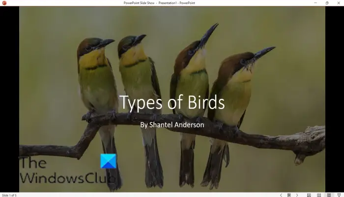

How to switch to Reading view in PowerPoint
Click the View tab and select Reading view in the Presentation views group.
The Reading view plays your PowerPoint to see your animation or transitions without switching to a full-screen slide show.
You can use your arrow keys on the keyboard to navigate through the slides.
To exit the Reading view, Press the Esc key on the keyboard.

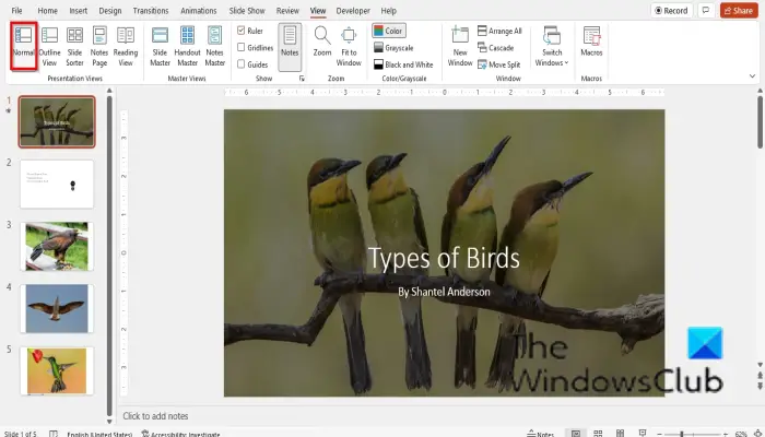

How to switch to Normal view in PowerPoint
Click the Normal view to return to the original presentation view.
In the Normal view, edit your presentation slide by slide and navigate with thumbnails on the left side.
