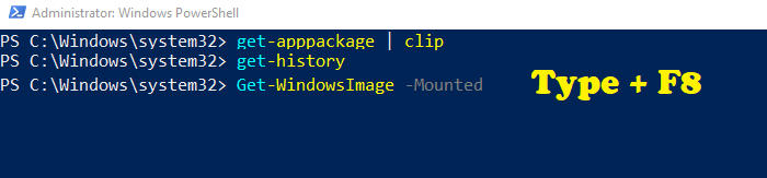

1] Keyboard Method
I am sure you have used the Command Prompt once if you have used Windows for some time. If you use the arrow keys up and down, you can go back and forth of the executed commands. The same applies to PowerShell as well. But here is the twist. If you remember a command partially, here is how to search.
- Type part of the command you remember
- Press F8, and keep pressing it until you find.
- The search term will be highlighted with a fluorescent green, followed by the rest of the command.
The only drawback is that the search term has to be the start of the command.

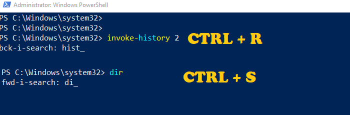

2] Search Forward or Backward in History
If you want to search forward or backward in History, then you can use Ctrl + R and Ctrl + S. The former lets you search back in History while the later forward. As soon as you use the keyboard shortcut, you should get a snippet at the bottom (bck-i-search or fwd-i-search). Type what you want to search, and even if the text belongs to somewhere in the middle of the command, it will search for it. It is much better compared to the F8 method we used above.

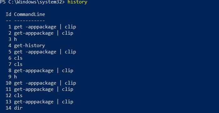

3] View the entire PowerShell command History of this session
Type History, and press the Enter key. You should be able to see all the commands you executed in the current session. While you can view the commands executed in the earlier session using the arrow keys, the History will not have it. If you press the key “H” and hit enter, it will do reveal the History of commands. Consider it as a shortcut to the History command.

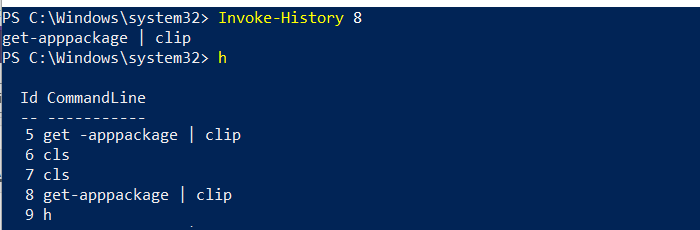

4] Invoke a particular command from the PowerShell command History
If you notice, the image above has an ID next to each command. If you want to execute one specific command from the list, you need to use Invoke-History.
- Note the ID of the command you want to execute
- Type Invoke-History <ID>. Replace <ID> with the exact number
- Press the Enter Key, and it will execute that command from History.
