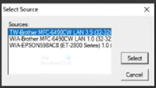

To begin the connection, make sure that the scanner is connected to the computer and that it is powered on. In GIMP go to File then Create then Scanner/camera.
You will see the Select source window appear. You will see the available scanner or scanners displayed. Choose the scanner that you want then press Select.
The Scanner setup page will pop up for you to choose the settings that you want for the scan. You can change the Scan resolution of the document by pressing the drop-down arrow under Resolution. You can then select the desired resolution that you want for the scanned document. You can make other adjustments to suit your preferences.
