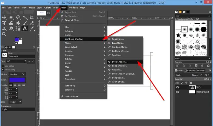

Open GIMP and enter your text on the canvas.
Click the Filters tab on the menu bar.
In the drop-down list, click Light and Shadow and select Drop Shadow.
Once selected, a Drop Shadow dialog box will appear.
