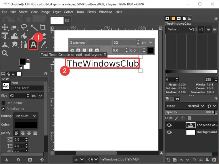

Now, add your text to the image by using the Text tool present in the Toolbox at the left. You can customize the font, size, and color of added text.

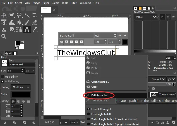

After adding and customizing the text, right-click on the text, and from the context menu, select the Path from Text option.

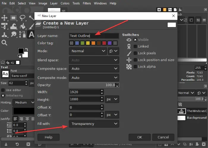

Next, you need to add a new layer. Go to the Layer menu and click on the New Layer option or simply press the Shift+Ctrl+N hotkey to add a new layer.
A pop-up will open to configure the layer settings. Here, you need to set the Fill with field to Transparency value. And, name layer something like Text Outline or Outline of Text. Press the OK button after setting up these options.

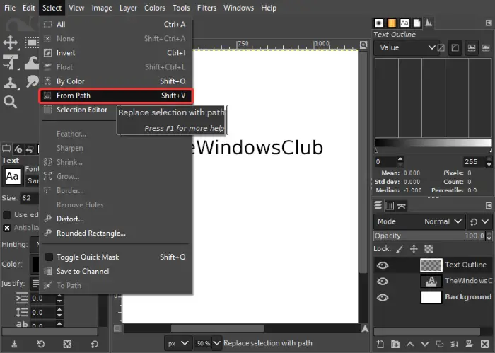

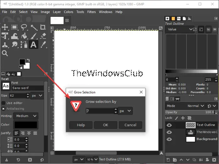

After that, go to the Select menu and tap on the From Path option. You will see your text is highlighted.
Now, again move to the Select menu and click on the Grow option. A small dialog box will open up where you can select the grow size. Make it something like 8 or 10 pixels or whatever you prefer.

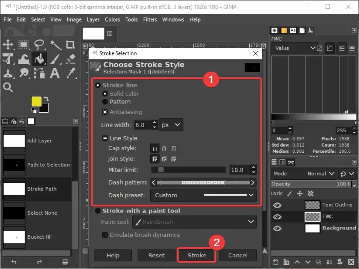

Go to the Edit menu now and from here, click on the Stroke Selection option. A dialog box will open up where you need to select the Stroke Line option and then set up various options like solid line, line style, dash pattern, line width, etc. After setting up these options, press the Stroke option.
And, Voila! You will see an outline added to your text.

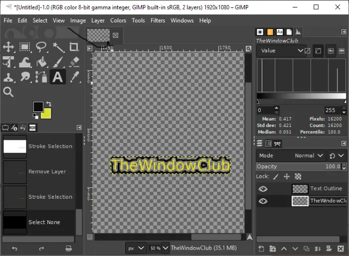

If you want, you can remove the background layer to create outlined text with transparent background. Right-click on the background layer and click on the Delete Layer option. After that, repeat the above step by going to Edit > Stroke Selection and adding a stroke line.
You can now export the outlined text in several image formats including PNG, JPG, WebP, GIF, BMP, PDF, and many more.
