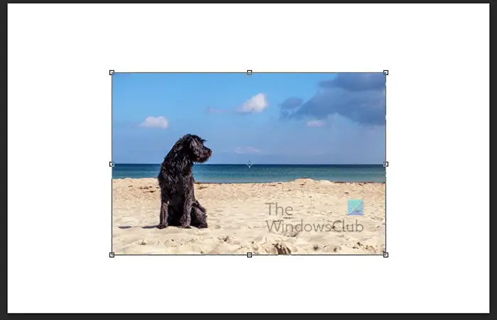

In this step, you want to place the image of your choice on the canvas you created in the previous step. To place the image into Photoshop on the canvas, you can just find the image then click and drag it into Photoshop. If you use the option to go to the top menu then press File then Open and select the image, the image will open into a new document. You will then have to drag it onto the previously created canvas.

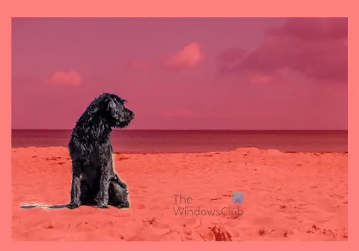

To check that the selection is done properly you will use the Quick mask.
To use Quick Mask, press Q on the keyboard. The surrounding of the selection will become pale red while the selection will remain bright. To get the Quick mask off press Q again and it will be removed.
Correct selection
If you realize that the selection missed out any part or took in unwanted parts, you can correct the selection. Use the Quick mask tool to check how successful your selection is. When you have had a successful selection, you can move on to the next step.

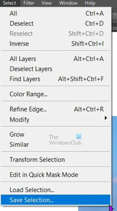

With the selection around the image it is time to save the selection. There are two ways that you can save the selection.
You can go to the top menu bar then click Select then Save selection.

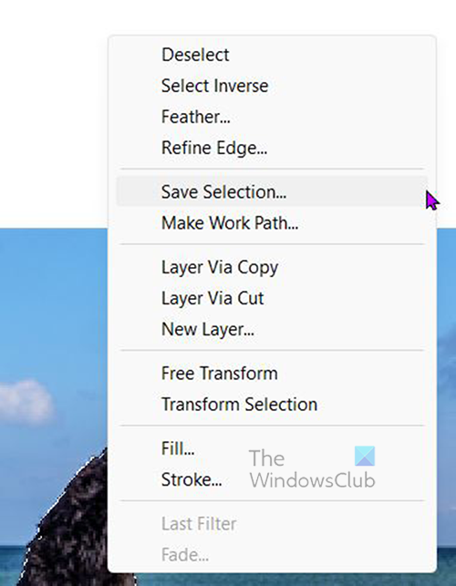

The next way is to right-click on the image while the selection is around it. you will see the menu, choose Save selection.

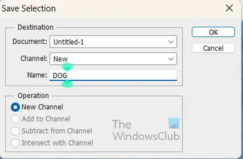

When you choose Save selection, the Save selection box will pop up. Here you will give the selection a descriptive name. This selection will be named Dog since it is a selection of a dog. Press Ok when you are finished to close the window. Press Ctrl + D to deselect the image.

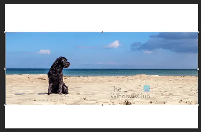

Image before resizing
The image was resized the normal way by stretching without using Content-aware. You will notice that the subject is distorted.
The image was resized using the Content-aware scale and the saved selection. You notice that the subject remains unstretched and is not distorted.
Above you can see the image in its original state on the canvas, then when it was resized normally, and then when it was resized using the Content-aware scale. You will see that the image remained the same size when the Content-aware scale was used.
