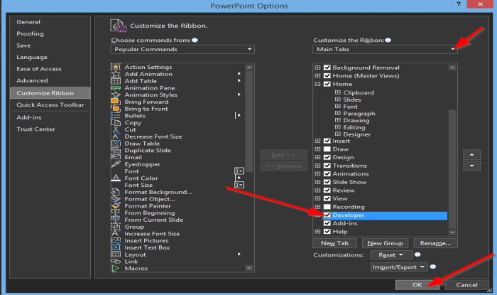

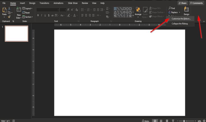

To add a ComboBox into a slide, we need to add the Developer tab.
To add dd the Developer tab, click the end of the Standard toolbar on the right and select customize Ribbon.
A PowerPoint Options dialog box will appear.
Inside the dialog box under the Main Tabs category, check the checkbox for the Developer tab.
Then click OK.
You will see the Developer tab appear on the menu bar.

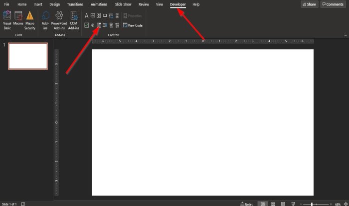

Click the Developer tab, click the ComboBox in the Controls group.
Draw the ComboBox into the slide.

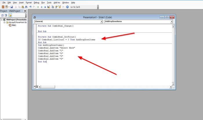

Now we will add code to add the menu choices.

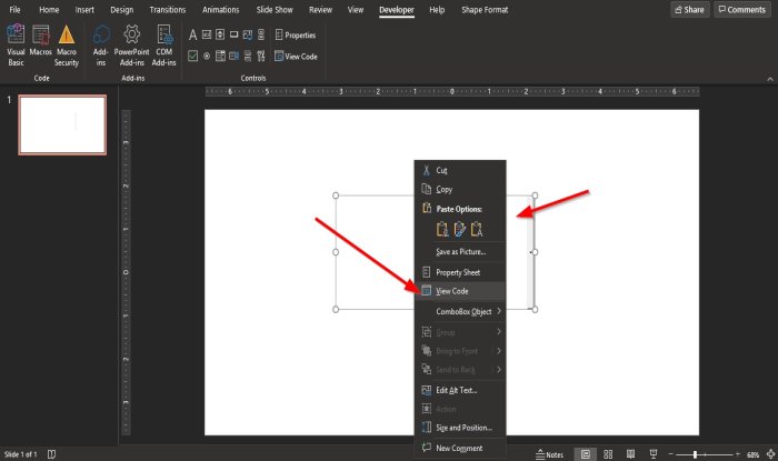

Right-click the Combo box and select View Code.
A Microsoft Visual Basic for Applications window will open.

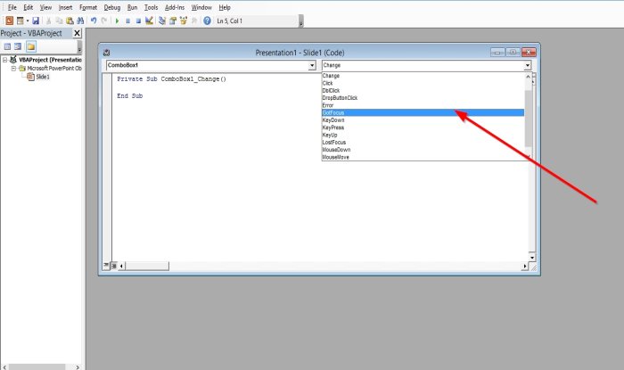

Click the drop-down menu on the right and select GoFocus.
Now add the Visual Basic Code below.
If ComboBox1.ListCount = 0 Then AddDropDownItems.
Press enter and add this code below.
Sub AddDropDownItems()
ComboBox1.AddItem “1”
ComboBox1.AddItem “2”
ComboBox1.AddItem “3”
ComboBox1.AddItem “4”
ComboBox1.ListRows = 4
End Sub

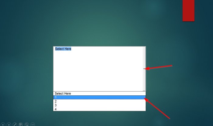

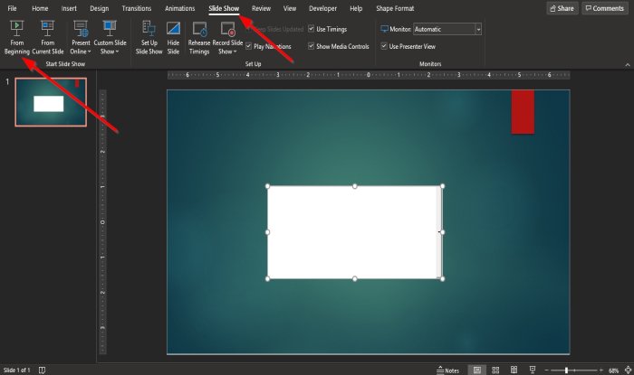

Click the Slide Show tab on the menu bar and click the From beginning button.
When the slide show window pops up, click the arrow to display the options.
