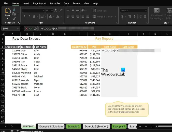

3] Add data for reference
In the primary workbook, you must add data for reference if you haven’t already.
As you can see from the picture, our reference data has already been included.
4] Add formula and select data
The next step is to add the formula needed to get things moving in the right direction.
Go ahead and type, =VLOOKUP(
From there, you must now click on the relevant data to have it included in the formula, then add a comma.
So, if you decided to go with A4, then the formula will look like this: =VLOOKUP(A4

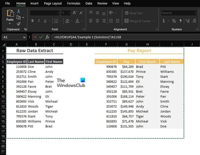

5] Go to the workbook with the data
After you’ve typed the formula as above, you must now move over to the workbook that contains the data you want to search through.
Go to the very bottom of your workbook and select the relevant tab.
6] Select the data you want to search through
From within the newly selected workbook, please highlight the data you want to search through.
It can be everything or just a selected few, it doesn’t matter.

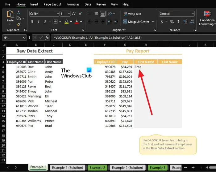

7] Add to the formula
The next step right after selecting the data you want to work with, is to type a comma.
So, your formula should extend to look like the following:
=VLOOKUP('Example 1'!A4,'Example 1 (Solution)'!A2:I16,
8] Find the relevant values from other workbooks
Finally, we are going to locate the values from the workbook with the data for display in the primary workbook.
To do this, you must determine which column of data must be shown.
As you can see, we have gone with column number 5, so the final formula should look similar to the following:
=VLOOKUP('Example 1'!A4,'Example 1 (Solution)'!A2:I16,8)
The information from column 5 of the workbook with all the data should now be visible in the primary workbook.
