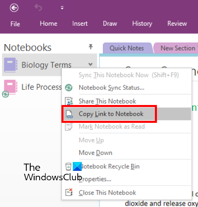

1] How to create links to notebooks in OneNote
The following steps will help you create links to notebooks in OneNote.
- Open OneNote.
- Open the notebook for which you want to create a link.
- Right-click on the notebook and then select Copy Link to Notebook. This will create a link to that notebook and copy it to the clipboard automatically.
- Now, you can paste the copied link anywhere in OneNote.
- Open the notebook which you want to link with the one, the link of which you have created, and paste the link there.
When you click on the link, OneNote will open the linked notebook automatically. You can also add this link to a custom text. For this, select the text and press Ctrl + K keys, and then paste the link in the Address section. When you are done, click OK.

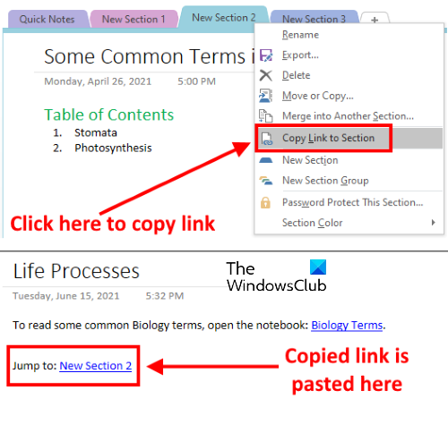

2] How to create links to sections in OneNote
In OneNote, you can link one section to the other section and pages by creating links. For this, you have to follow the steps given below:
- Open your notebook in OneNote.
- Open the section in your notebook for which you want to generate a link.
- Right-click on the section and select the Copy Link to Section option. This will copy the link of the targeted section to the clipboard.
- You can paste this link anywhere in OneNote.

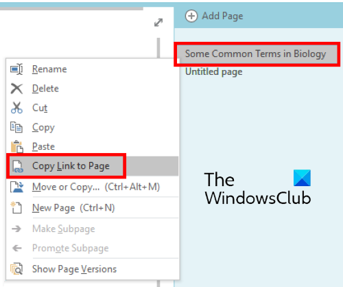

3] How to create links to pages in OneNote
We have listed the steps to create links to pages in OneNote below:
- Right-click on the page that you want to link to another page. In OneNote 2016, the pages are available on the right side. This may differ in different versions of OneNote.
- Now, paste this link anywhere in OneNote. When you click on this link, it will open the targeted page.

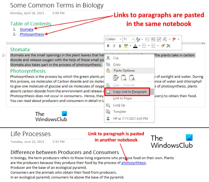

4] How to create links to paragraphs in OneNote
The following steps will guide you on how to create links to paragraphs in OneNote:
- Open your notebook in OneNote 2016.
- Select the paragraph that you want to link.
- Right-click on it and select the Copy Link to Paragraph option.
- Now, select the word or sentence that you want to link with the targeted paragraph.
- Press the Ctrl + K keys and paste the link in the Address section. When you are done, click OK.
By using the Link to Paragraph option, you can also link the Table of Contents in your notebook.

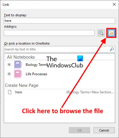

1] How to link a file in Microsoft OneNote
The steps that we will list here are also applicable to other OneNote versions, like OneNote 2024, 2021, etc. We have explained here the steps to link a Word document to OneNote. By following the same process, you can link a file with any extension to OneNote.
- Launch OneNote and open your notebook in it.
- Select a custom text which you want to link with a file on your hard drive.
- Now, you have to hyperlink the selected text. For this, go to “Insert > link” or simply press the Ctrl + K keys on your keyboard. After that, a new window will open.
- Click on the Browse button and select the file that you want to link. After selecting the file from your computer, click OK and then OK again to save the link in OneNote.
- The custom text has been linked to the file that you have selected. Now, you can open the file directly from OneNote with a single click.

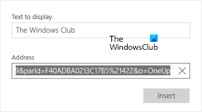

2] How to link a file in OneNote app for Windows
If you link a file in the OneNote app for Windows by following the same process as explained above, it will not work. Every time you click on the hyperlinked text, the OneNote app for Windows will display the following error message:
Sorry we couldn’t open that link. it’s destination may have been moved or you may no longer have access to it.
Hence, if you want to link a file to OneNote app for Windows, you have to upload it to OneDrive.
The following steps will help you with that:
- Open OneDrive in your web browser and sign in to your account.
- Now, upload the file to OneDrive. For this, go to “Upload > Files” and select the file on your computer.
- After uploading the file to OneDrive, copy the link from your web browser’s address bar.
- Launch OneNote app for Windows.
- Select the text that you want to link with the file that you have uploaded to OneDrive.
- Press the Ctrl + K keys and paste the copied link in the Address section.
- When you are done, click Insert.
When you click on the link, the file will open in OneDrive in your default browser. However, you should have an active internet connection.

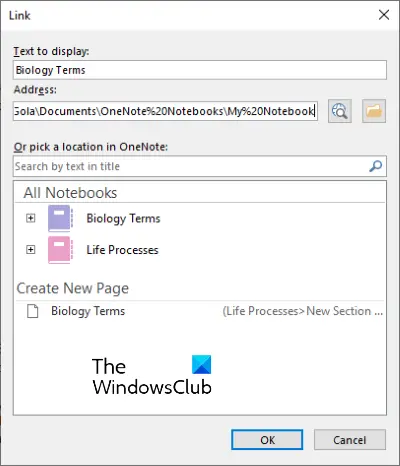

1] How to link a folder in Microsoft OneNote
The following steps are applicable to OneNote versions like OneNote 2024, 2021, etc.
- Open the folder on your computer.
- Click on the File Explorer’s address bar and copy the entire path of the folder.
- Now, launch OneNote and select the text to link with that folder.
- Press the Ctrl + K keys and paste the copied path in the Address section.
- When you are done, click OK.
Now, clicking on the hyperlinked text will open the targeted folder.
