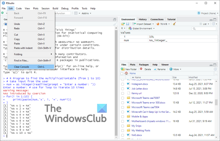

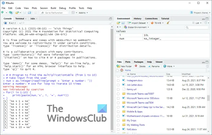

1] Via button combinations
First, press the CTRL key along with the L key, and right away, the screen will refresh and then show the empty console, suggesting it has been cleared.
Alternatively, click on Edit > Clear Console, and that should get the job done just as well.
