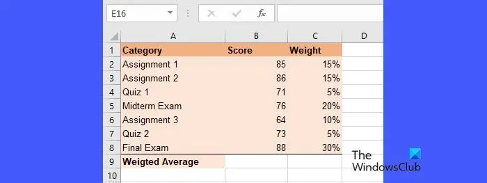

Now coming to the point, let us say we have a sample data set from a grading system (as shown in the image below), where a specific weight has been assigned to the assignments, quizzes, and exams to calculate the final score of a student.
These weights could either add up to 100% or not necessarily add up to 100%. Let us see how to use the SUM function to calculate the weighted average in both of these scenarios.

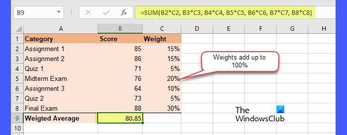

A] Calculating Weighted Average when the weights add up to 100%
The above image shows the data set where the weights add up to 100%. To calculate the weighted average of this data set in Excel, follow these steps:
- Place your cursor in cell B9 (where the weighted average needs to be shown).
- Write the following function in the Formula bar on top:
=SUM(B2*C2, B3*C3, B4*C4, B5*C5, B6*C6, B7*C7, B8*C8) - Press the Enter key.
In the above function, we have used the SUM function and the multiplication operator to calculate the average. What we are doing here is basically we are multiplying each data value by its weight and then adding the products to calculate the weighted average. Now since the weights add up to 100%, the basic SUM function will do the maths. However, if the weights DON’T add up to 100%, the calculation will differ slightly. Let’s see how.

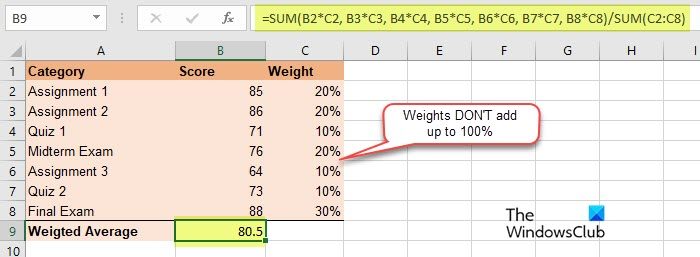

B] Calculating Weighted Average when the weights don’t add up to 100%
To calculate the weighted average where the weights don’t add up to 100%, each data value is first multiplied by its own weight, and then the sum of these weighted values is divided by the sum of the weights. This is how you do it in Excel:
- Place your cursor in cell B9.
- Write the following function in the Formula bar:
=SUM(B2*C2, B3*C3, B4*C4, B5*C5, B6*C6, B7*C7, B8*C8)/SUM (C2:C8) - Press the Enter key.
Now as you can see, the weighted average comes exactly the same as in Case A.

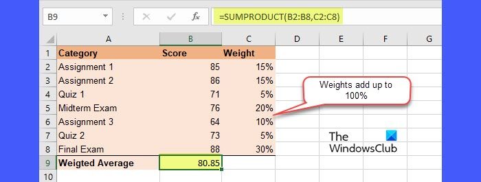

=SUMPRODUCT(B2:B8,C2:C8) - Press the Enter key.
Now here, the SUMPRODUCT function is multiplying the first element in the first array by the first element in the second array. Then it is multiplying the second element in the first array by the second element in the second array. After multiplying all the corresponding elements from the 2 arrays, the function is adding the products together to get the desired average.

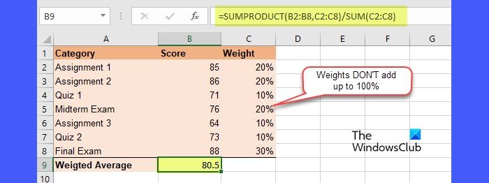

Again, in the case of the SUMPRODUCT function, if the weights don’t add up to 100%, we need to divide the resultant value by the sum of the weights to get the weighted average. Here’s how to do it in Excel:
=SUMPRODUCT(B2:B8,C2:C8)/SUM(C2:C8) - Press the Enter key.
Now as you can see in the image, the average comes to 80.85, which is the correct result.
