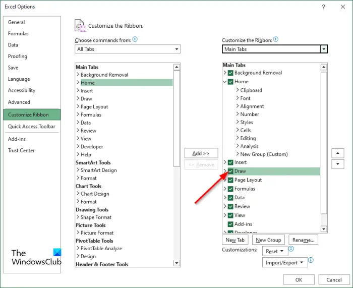

How to add Draw tab in Excel
- Launch Excel.
- Click the File tab, then click Options on the backstage view.
- An Excel Options dialog box will open.
- Click Customize Ribbon on the left pane.
- On the right, in the box of the Main tab, enable the Draw tab by checking the Draw tab check box.
- Then click OK.
- The Draw tab will be enabled on the menu bar.

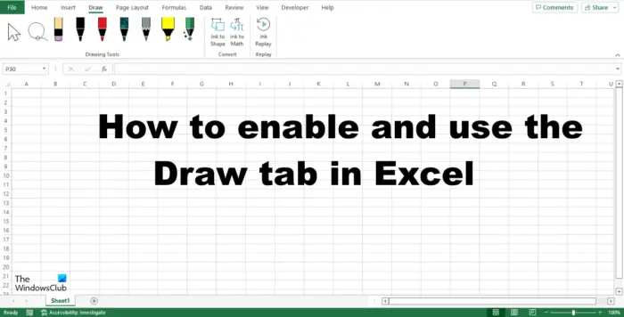

How to use Draw tab in Excel
On the Draw tab, there are various drawing tools that you can use, namely:
Select tool: Select objects such as ink, shapes, and text area. They are useful when working with objects behind the text. To use the Select tool, draw with a pen on the spreadsheet and use the Select tool to select and move it.
Lasso Select: Select ink by drawing a shape. All the strokes in the shape will be selected. To use the Lasso Select tool, click the Lasso Select button, then draw it over the ink shape. You can now move the ink around the spreadsheet.
Eraser: The Eraser is used to remove the ink that has been drawn on the page. Click the Eraser button to erase the ink in the spreadsheet.
The Pen and Pencil tool: Enables users to draw on the spreadsheet. Click the Pen or Pencil tool and draw on the spreadsheet. You can choose the color and width of the pencil or pen.
Highlighter: Use to Highlight text or draw on the spreadsheet. Click the Highlighter button and highlight the text.
Action Pen: Use the action pen to enter data by handwriting. To use the Action Pen, click the Action Pen button and select Ink Gesture Help. A Help pane will appear on the right with some instructions on how to use the Action pen. Follow the instructions (See the photo above.) Press the ESC button to escape the Action Pen.
Ink to Shape: Automatically convert Ink drawing to shape.
Ink to Math: Convert handwritten mathematical expressions to text. Click the Ink to Math button, and a Math Input Control dialog box will open. Now write within the box. You will see a conversion of the math you wrote in the box on the box above. Now click Insert.
Ink Replay: automatically replays the creation of visible ink strokes. Click the button to replay the ink strokes.
You can use the features as required.
