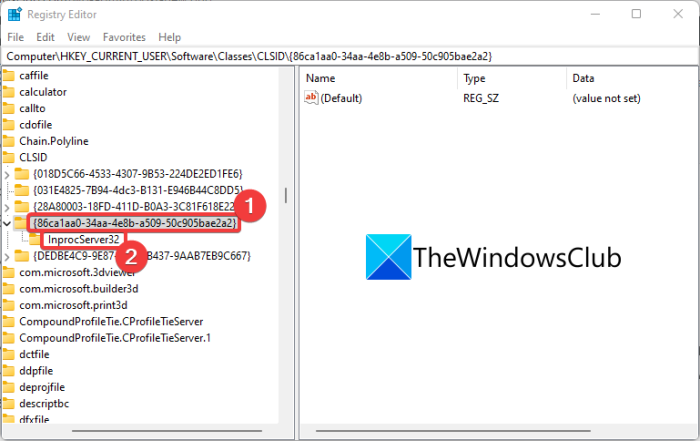

Now, check here whether there is a key with the {86ca1aa0-34aa-4e8b-a509-50c905bae2a2} name or not.
You will most probably not find this key here. So, you will need to manually {86ca1aa0-34aa-4e8b-a509-50c905bae2a2}.
To create a new key, right-click on the empty space in the left-side panel or on the CLSID key from the left panel, and then select the New > Key option. A new key will be created. Right-click on the newly created key, select the Rename option and name it {86ca1aa0-34aa-4e8b-a509-50c905bae2a2}.

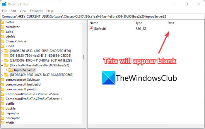

After that, you need to create a sub-key under the above key ({86ca1aa0-34aa-4e8b-a509-50c905bae2a2}) that you just created. For that, simply right-click on the newly created key, and from the appeared context menu options, click on the New > Key option and name the key as InprocServer32.

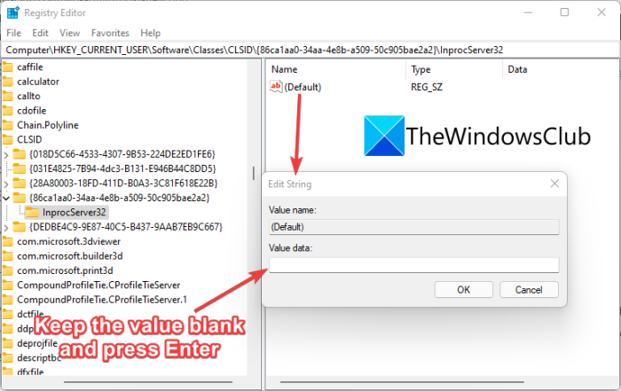

Next, from the right panel, double-click on the Default string.
In the opened dialog box, make sure the Value data field is blank and press the Enter button.
Finally, close the Registry Editor app and then restart your PC. If you don’t want to restart your PC, you can also restart Windows Explorer to save and apply changes. For that, open Task Manager by clicking on the Ctrl + Shift + Esc hotkey, select Windows Explorer under the Processes tab and hit the Restart button.

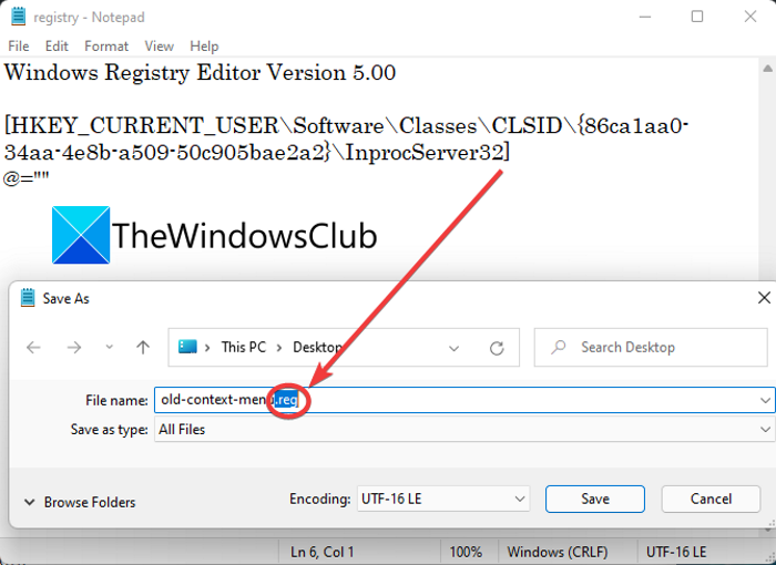

First, open Notepad on your Windows 11 PC. Now, enter the Registry version, followed by the relevant registry keys and their values. You can simply copy and paste the below code for that:
Windows Registry Editor Version 5.00
[HKEY_CURRENT_USER\Software\Classes\CLSID\{86ca1aa0-34aa-4e8b-a509-50c905bae2a2}\InprocServer32]
Now, save the Registry file and for that, click on the File > Save as option. Then, select the Save as type to All Files and then enter the filename followed by the .reg file extension. This will create a registry file.
After that, simply run the create registry file by double-clicking on it.
Finally, restart your computer to let the change reflect. You will now get back to your old right-click context menu.

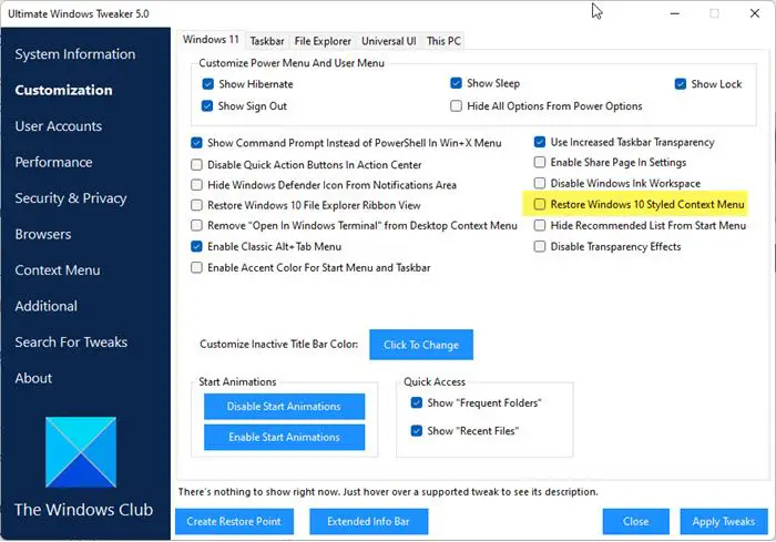

4] Use Ultimate Windows Tweaker
Download and use our freeware Ultimate Windows Tweaker. Run it as admin and apply the Restore Windows 10 Styled Context Menu tweak. You will find it under the Customization > Windows 11 tab.
