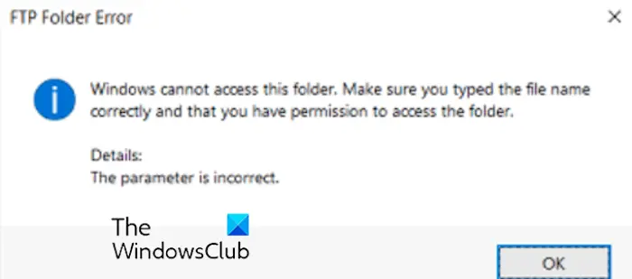

FTP (File Transfer Protocol) is a standard network protocol used for accessing or transferring files between a client and a server over a computer network. However, some users have reported experiencing an FTP Folder Error with the following error message while accessing FTP:
Windows cannot access this folder. Make sure you typed the file name correctly and that you have permission to access the folder.
Details: The parameter is incorrect.

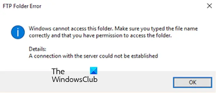

Another error message that you might get with this error is:
Details: A connection with the server could not be established.

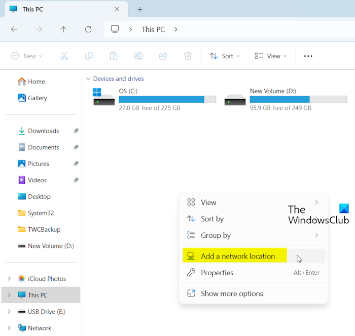

First, open the Windows Explorer using Win+E and go to This PC.
After that, right-click on the empty part of the window and choose the Add a network location option from the context menu.

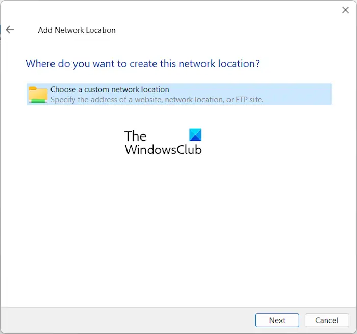

Now, click on the Choose a custom network location option and then press the Next button.

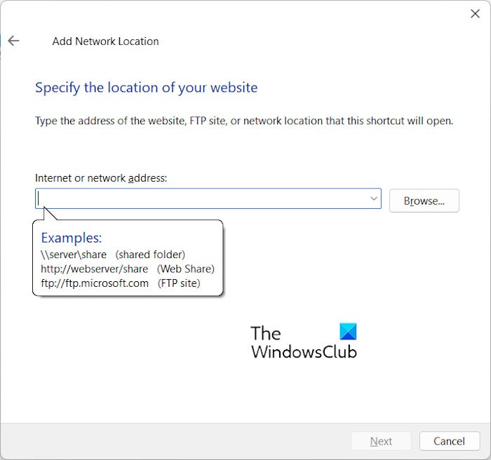

Next, enter the address of the target FTP site in the Internet or network address box and click on the Next button.
After that, follow the instructions to complete the setup process, and it will create an FTP site shortcut in your This PC folder. If you wish, you can also drag it to your desktop to suit your convenience.
You can try connecting to this FTP site and see if the error is gone.

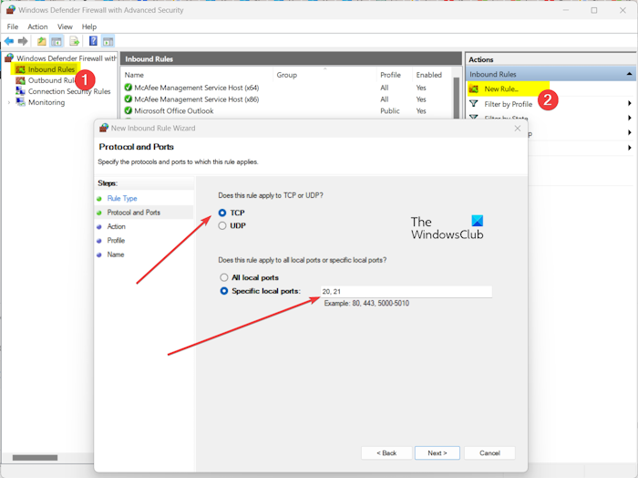

It might be the case that your firewall is blocking the FTP port which is why this error is triggered. Hence, you can allow FTP ports in your firewall to fix the error. Here’s how:
First, open the Windows Defender Firewall using search and then click on the Advanced settings option from the left-side pane.
Now, click on Inbound Rules and then select the New Rule option.
After that, select Port as the rule type and hit the Next button.
Next, choose TCP and then enter “20, 21” in the Specified local ports box. These ports are used for FTP connection by default.
Now, press the Next button.
After that, choose the Allow the connection option and click on Next.
Next, tick the Domain, Private, and Public checkboxes to apply the newly created rule and tap on Next.
Now, enter the name of the rule e.g., FTP rule, FTP ports, etc. and hit the Finish button to complete the process.
This will open the FTP ports on Windows Firewall. You can now check if the error is fixed.
