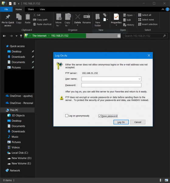

In this task, we will not be modifying any major settings on your computer. All you need to do is, start by opening the File Explorer. Then in the address bar, type in the IP Address in the format as:
ftp://192.168.xxx.xxx
You will get a pop up asking for your credentials.
As per the configurations are done and applied by you while setting up the FTP Server, you can use the desired User name and Password to access this FTP Server.
When you click on Log On after entering your user name and password, it will open a new window with a successful authentication and open the hosted files.
