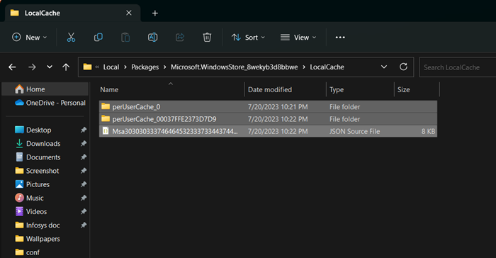

4] Delete Microsoft Store Local Cache
There are various instances when the Store fails to operate as it should, or maybe one or more apps are acting up. And we have seen that this mostly occurs due to corrupted caches. However, this is easily fixable as it just demands a thorough clean-up.
Here’s how to clear the Microsoft Store LocalCache folder contents:
- Click Win + R to open the Run dialogue Box, and then type %userprofile%.
- Click the OK button to open the user profile folder in File Explorer.
- Click on the AppData folder. If you can’t find that, then in that case, unhide the hidden files and folders.
- Once done, navigate to the Local folder, open the Packages folder, and then Scroll down
- Locate and open Microsoft.WindowsStore_8wekyb3d8bbwe folder and find the LocalCache folder.
- Open the folder, delete all its files, and restart the computer.
Finally, check if your issue is resolved.

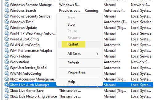

6] Start or Restart all the Xbox services
Xbox, to run smoothly, needs services that work in the background, and if these services are disabled, then the computer will most probably have difficulty launching the game. Simply enable or disable and then enable this service by following the steps mentioned below:
- Click Win+R to open the Run dialogue box, and then type services.msc to open Services Window.
- Now hit the Enter button, find, and right-click on a service that has Xbox in its name.
- Select the Properties option, and then switch the Startup type to Automatic. Also, select Start if the service was not enabled. If it was enabled, disable it and then enable it
- Hit the Apply and OK buttons, and do the same for other Xbox services.
Now, relaunch the Xbox app and then the game, and hopefully, you will have smooth gameplay.
