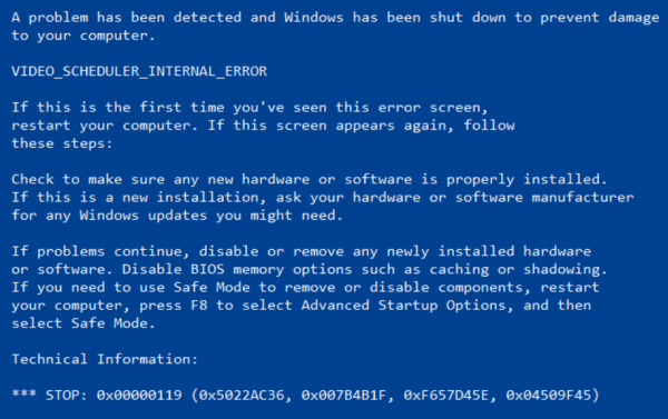

The Graphics Card on a computer is a very important component of a computer. They are responsible for rendering a number of objects on your computer. But there can be scenarios when the performance of this rendering can degrade, and your computer can trigger a blue screen error with the message VIDEO SCHEDULER INTERNAL ERROR.
The VIDEO_SCHEDULER_INTERNAL_ERROR bug check has a value of 0x00000119. This indicates that the video scheduler has detected a fatal violation.
Today, we will be discussing how to fix it.
VIDEO_SCHEDULER_INTERNAL_ERROR 0x00000119
