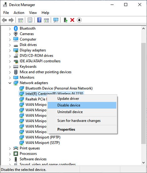

1] Enable Network Adapter
Trying to disable and enable network drivers may resolve the issue.

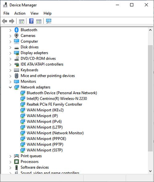

1] Press the Windows key and type Device Manager in the search bar and open it.
2] Now click Network adapters to see the different network drivers on your Windows device.
3] Now right-click on the network driver that is causing the issue, and click on Disable Device.
4] A dialog box will appear asking if you want to disable the particular network adapter. Click Yes.
5] Now go back to the same network adapter and right-click on it. Now select Enable Device to enable the network adapter again.

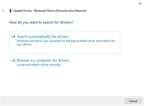

6] Once enabled, click on Update driver. A window of Update Drivers opens with this. Click on Search automatically for updated driver software. This will fix any pending updates of the driver.

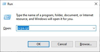

1] Press Windows Key + R to open the Run window.
2] Type ncpa.cpl and click on OK.
3] It opens the Network Connections window. Now right-click on the Wi-Fi network connection and click on Enable.

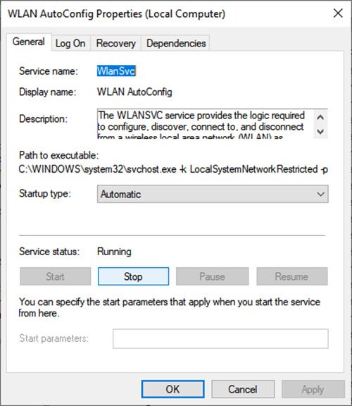

3] Automate “WLAN AutoConfig”
Sometimes all it takes to automate certain services to make the wifi and network up and running.

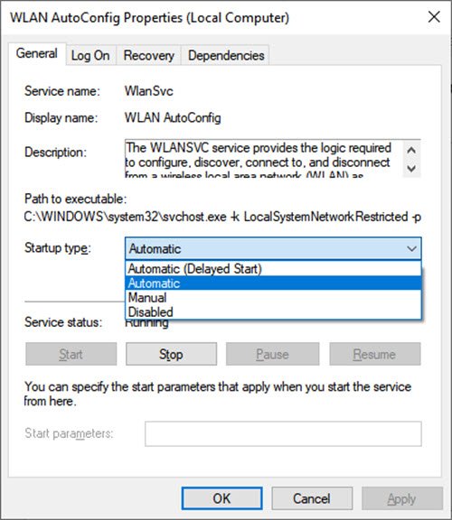

1] Click the Windows key and type Services. Now open the app.
2] In this window, double-click on WLAN AutoConfig. This will open the WLAN AutoConfig Properties window.
3] Check the Startup type. If it is Manual or Disabled, change it to Automatic. Click OK.

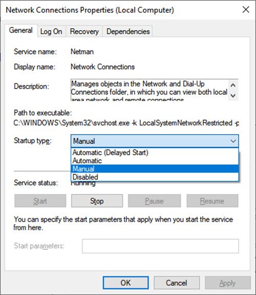

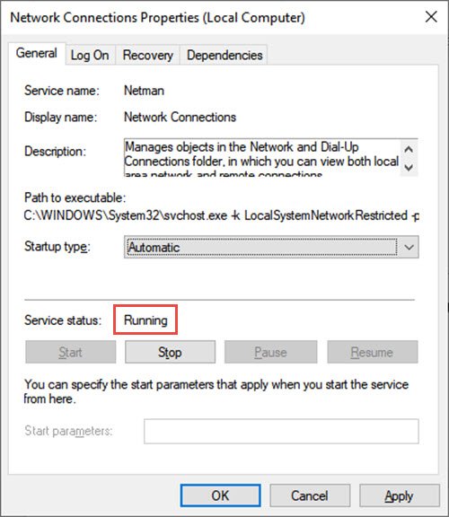

4] Now, in the Services window, double-click on Network Connections. This will open the Network Connection Properties window.
5] Change the Startup Type to Automatic.
6] In the same window, click on Start to start the service if the Service Status is Stopped.
7] Click OK and then Apply to make the changes effective.

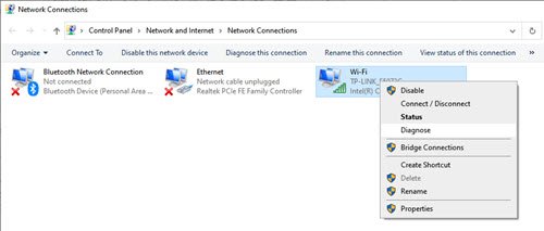

- Press Windows Key + R to open the Run window.
- Type ncpa.cpl and click on OK.
- It opens the Network Connections window. Right-click on the network or the Wi-Fi having the trouble. Click on Diagnose to run the diagnostic of the network connection.

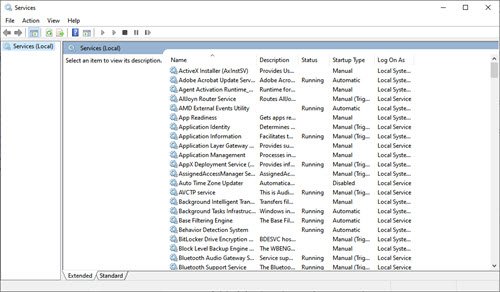

5] Check that the following services are enabled
1] Press Windows Key + R.
2] Type services.msc in the box. Check if these services are enabled:
- TCP/IP NetBIOS Helper service
- Wireless LAN
- DHCP
- DNS Client
- Function Discovery Resource Publication
- SSDP Discovery – UPnP Device Host
To start the service and set it to Automatic, follow these steps:
- Right-click each of the services listed above and click on Properties.
- Click the General tab, and then, next to Startup type, select Automatic.
- Click Apply, and then click Start.
