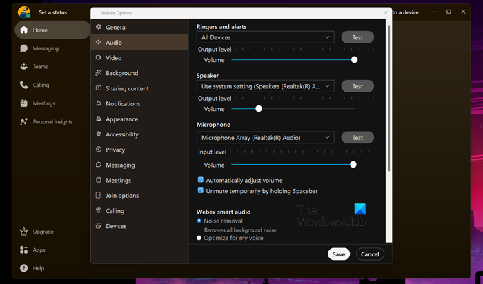

4] Configure Audio Settings
Next up, we need to configure the audio settings of the Webex app and make sure that the audio device is selected correctly. When you first install Webex, the app automatically gets configured correctly and then is altered once any changes are made to the audio settings of Windows settings. This process is mostly done pretty smartly, but sometimes, this can misconfigure the settings and cause issues. To do the same, follow the prescribed steps.
- Open Cisco Webex.
- Click on Settings (cog button).
- Go to Audio.
- Go to Microphone, click on the drop-down menu, and then select Use System settings.
- Do the same to Speaker.
- Finally, click on the Save button.
After making all the adjustments, restart Webex and see if the issue is resolved.
If you are in a meeting and want to change the audio device, just click on the drop-down menu next to the Mute/Unmute button and then select a device. You need to make sure that the device that you are using is connected to your system, whether it is connected via Bluetooth or wire, you will see its name there.
