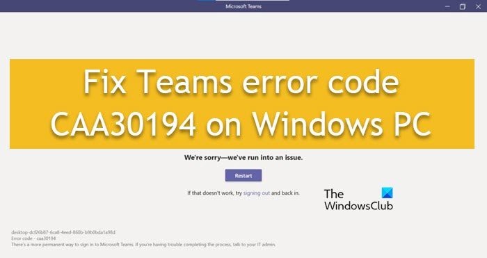

Microsoft Teams has its share of login errors and one of them is Error Code CAA530194, which stops the users from logging into Microsoft Teams. This generally indicates that Teams is having trouble contacting the correct servers. If you facing this issue, check out this article because here we talked about solutions to resolve Teams error code CAA30194.
What is error code CAA30194?
The Teams error code CAA30194 is a login error code that generally appears when clients on a desktop try to log in, but are not able to connect to the Microsoft server. This can be due to some glitches, corrupted cache, misconfigured JSON files, etc.
Fix Teams Error Code CAA30194 on Windows PC
If you get Teams error code CAA30194 and are unable to log in on a Windows PC, first try signing out and then back in, and if that does not help, execute the following solutions:

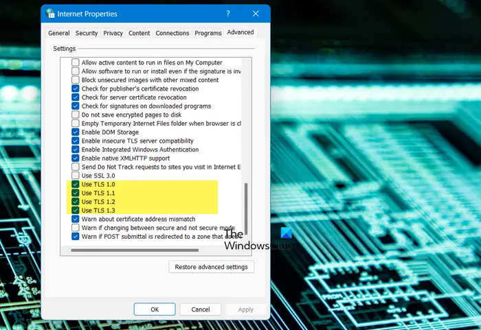

4] Enable the TLS feature in the Internet option
Try enabling the TLS feature in the Internet option. Doing so will prevent the device from switching off the connection by providing a secure connection during data transfer.
Here’s how to enable TLS:
- Go to the Search bar, type, and select Internet Options from the pop-up panel.
- Click on the Advanced tab, and navigate to the Security section.
- See if TLS 1.0, TLS 1.1, TLS 1.2, and TLS 1.3 are enabled or not, if they are disabled, enable them.
- Finally, select the OK button to save the changes.
Run Microsoft Teams to see if the issue persists
