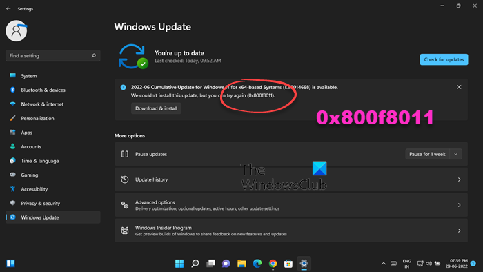

Microsoft ensures that features and fixes for bugs are rolled out to its users promptly via Windows Updates. However, these feature and system updates are often faced with several kinds of errors, one of which is the Error code 0x800f8011. This error is accompanied by the error message, “We couldn’t install this update, but you can try again,” and essentially restricts you from installing new updates. Today, we will see how you can fix the Windows update error 0x800f8011.
Fix Windows update error 0x800f8011
When you are facing the error 0x800f8011 while trying to install an update, it is sometimes a sign of certain files missing that are essential for the update process to go through. Alternatively, conflicting third-party antivirus software or out-of-date system drivers could also cause this issue. Let us now see what you can do to fix this problem.
