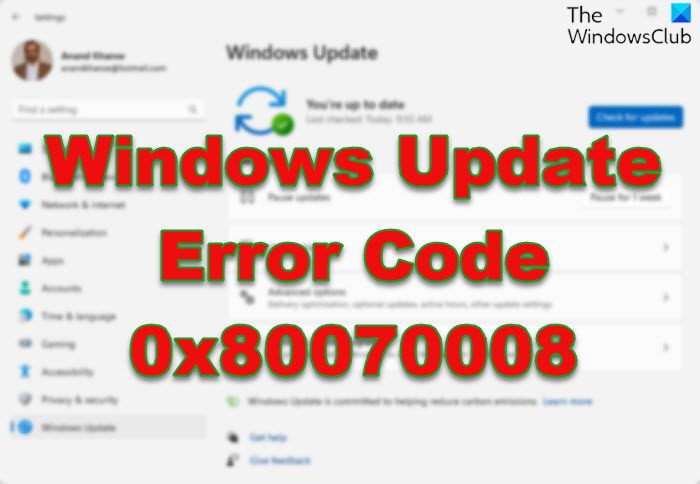

Some users encountered error code 0x80070008 while trying to update the Windows operating system to the latest version. There are many reasons for this issue such as insufficient disk space or memory, corrupted Windows Update system files, etc. In this post, we will discuss the issue in detail and find the solutions to resolve the 0x80070008 Windows Update Error.
0x80070008 – ERROR_NOT_ENOUGH_MEMORY, The system is out of memory.
Fix Windows Update Error Code 0x80070008
Lack of disk space or insufficient memory can cause Windows Update Error Code 0x80070008 to appear in Windows 11/10. The following are all the solutions you need to resolve this issue.
