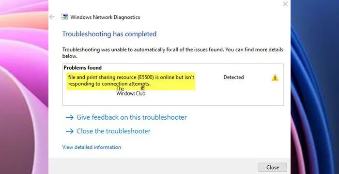

Many Windows users, when unable to access one or multiple shared connections or folders across the local network, try running Windows Network Diagnostics Troubleshooter to understand the problem. They may end up seeing an error stating File and Print sharing resource is online but isn’t responding to connection attempts. While this error is seen in the tool, in most cases, the users report that they can view the files over the shared local network. However, they are not able to access the local network. Hence, it is important for you as users to understand the reasons behind this error and the ways to fix this error.
Following are some common scenarios that are the reason for triggering the occurrence of this error:
