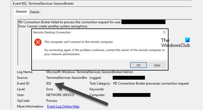

After setting up Remote Desktop Quick Start, when some Windows users tried to RDP to the RD Server, they received an error stating that Can’t connect to the remote computer. After probing about the error in Event Viewer, they see Event ID 802: RD Connection Broker failed to process has been registered message. In this post, we will see how to resolve the issue.
RD Connection Broker failed to process the connect requirest for user <username>
Error: Cannot create another system semaphore.
Event ID: 802
OR
Remote Desktop Connection
This computer can’t connect tot he remote computer.
Try connecting again. If the problem continues, contact the owner of the remote computer or your network administrator.
Fix Event ID 802: RD Connection Broker failed to process
If you get Event ID 802: RD Connection Broker failed to process and RDP to RD Server is not possible, first of all, reboot your system and then try. Sometimes, a glitch can trigger these issues, which can be easily resolved by rebooting the system.
In case, rebooting is to no avail, follow the solutions mentioned below.
